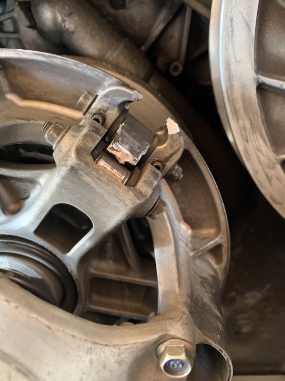

3rd picture,it's clear the rollers have no bushing in that picture, owner failed to inspect bushings which caused failure of clutch...Out on the lake this weekend with a buddy of mine. First pull rolling on from about 30 mph, and this happened to him at about 100.
Things I know:
It's been posted before, and I'll say it again -- these primary clutches NEED to be inspected frequently, and I would not be doing any hard pulls unless you know everything is 100% in your driveline.
- STM weights
- Dalton B/G primary, Dalton B/O secondary
- 22/41, 8JP
- 1.25 Ice Ripper track
- Rollers had a bit of play in them and were going to be swapped out
I have no confidence in the stock primary, and won't be running it next season.View attachment 147949View attachment 147949 View attachment 147950
View attachment 147949 View attachment 147950 View attachment 147951

Or make longer flyweights?

I would say the primary rollers are the weakest link if you stick with the Yamaha clutch. Kinda shitty that Yamaha didn't test the clutching calibration and left the buyers to figure #*$&@ out. Could be worse, we could be riding a pPolaris 800 and be putting engines in every few 1000kms instead of clutches.
