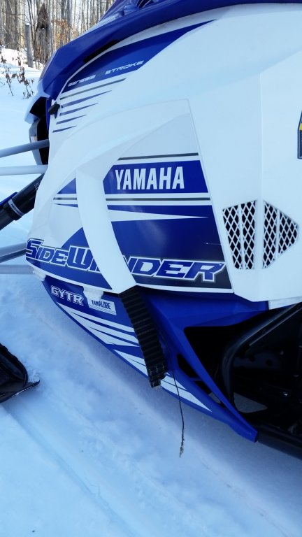

New 8JP belt and now after 1,200 miles. It was time to make some fast speed runs on revised #2 clutch kit. At 130mph GPS, the belt blew in half and actually pushed the side panel out with the belt "sticking it's tongue out". The reason why the belt blew was because the belt climbed over the inner sheave and was pinched between the engine and clutch. How do I know this? Because my gearing only allows me to run about 116mph....but I am overly machined for overdrive. There isn't even a magic-marker mark on my primary anymore.
