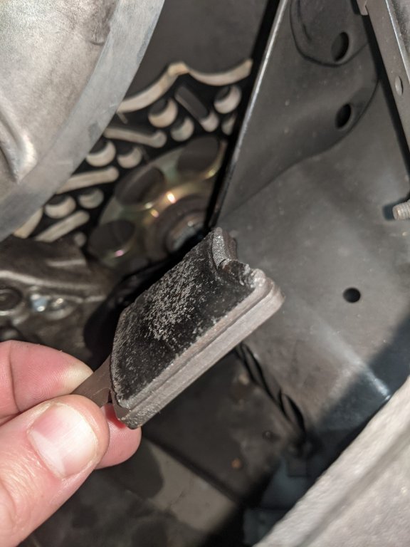

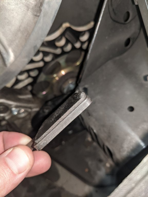

What the! Disc isnt small enough on ID. What disc is that? Ot did you just put that disc on and your old was grooved or something? You could just grind that area off a new set of pads. Definitly not Ideal for braking but I always put a chamfer on my pads leading and trailing edges to stop squealing and have never felt any loss in performance so I would do it.Wonder if this is part of my problem View attachment 168004View attachment 168005

Bdx light weight rotor, I did camfer the edges on the pads but the light weight rotor went through the pads fairly quickly.

To me, it looks like pads are toast. From pic 1 the center of pad is bubbled/toast. Mike once posted that made his brake lever spongy.Wonder if this is part of my problem View attachment 168004View attachment 168005
Yes, that BDX disc ate those pads something fierce. Never seen pads that worn!
I never had a spongy brake, always had a firm lever, just weak brakes that didn't want to stop without a lot of effort. I just wire brushed the pads to bring back the brake performance to new. I'm on the factory light weight race disc that came on the 17 LE's. though. I'm still running the stock pads that I wire brushed and brakes are great again. Must have just been severely glazed up.

Yeah they didn't look like that a thousand miles ago. I put the brake in because I took it on a 300 mile trip and it started to loose feeling after some high speed slow downs. Thought it was the
My kids 4000 RR has a light weight factory rotor so I figured this would be fine. That little lip on the pad was due to the inner section of the rotor being reduced in thickness.

The retaining pin hole on the fwd end of pad wears and pad sits deeper and allows wear like that. Happened to mine.
