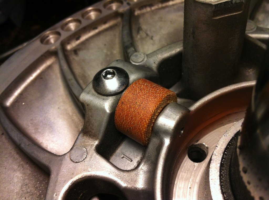

Looks kinda like the clutch bushings material.. That's cool!Those are HI-Torque rollers. Different then most all the others which are a Torlon Material. Hi Torque were one of the first to come out with heavy duty rollers many many yrs ago, when all others were failing. They are a fiber type material(not torlon) and I ran them on Toms last season with great success. I feel they are a softer material then Torlon, but that may be a good thing since on many sleds all 3 rollers may not touch equally, and this material seems to do well in aiding that.
They include a washer for shim on outside as shown in pic.

oh ok, thanks Dan for the info on the rollers.

Terry...I finally got my sled and at closer inspection these 18 rollers do look different then Toms 17 originals. I assume these are the new updated ones now. More squared off looking and a slight brownish color on sides(before use).
So these are not good either you are saying correct? I sorta had a feeling and did grab some OSP rollers(Torlon) for this winter.
thanks
Dan
Yes, the stock replacements aren't holding up.

Hey Dan...dont hold me to this and my eyes are old...but it looks like you have the roller in backwards?

First off that is a pic from last season, as I am running torlons.Hey Dan...dont hold me to this and my eyes are old...but it looks like you have the roller in backwards?
However, that is Toms sled, and those are installed properly...the thrust washer goes OUTWARD as shown.
Very nice rollers from western canada(BC?) and Holding up well for Tom. TD sells these too but they are actually made by HiTorque.

correct...thrust washer goes outward AND MACHINED STEP ON ROLLER INNER GOES AGAINST THRUST whereas it appears like the machined inner is facing away?

It was over a yr ago, I have no idea with these pics....I just followed his instructions.
I have not seen Tom at all, he has not come riding so far. But these rollers hold up well.
Yeah Edited this as Its been to long....trying to dig up old pics but cant find any that show better

Only one way to install these if you have common sense SJ.
Beveled edge and thrust washer wont work well together.![]()
I ran these on all mine and my buds DOO's....great conversations with Dan Salzmann over the years...the beveled or stepped edge is machined that way to reduce the surface area THAT GOES AGAINST the thrush washer for less friction..

I installed them exactly how he wanted...as I had a long talk with him about them.....I ran these on all mine and my buds DOO's....great conversations with Dan Salzmann over the years...the beveled or stepped edge is machined that way to reduce the surface area THAT GOES AGAINST the thrush washer for less friction..
Just trying to help the guy that helps all of us![]()
The ones I got looked nothing like the ones I had seen before, there was not any bevel like ones on his site.
have not even seen Tom since last winter, cant even look at it.
