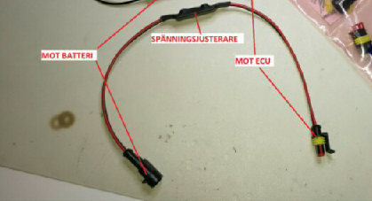

I have been testing a voltage adjuster to ECU that avoid voltage drops when cranking. A guy help me with the eloctronic. Put it in on the power supply to ECU.
Have been testing since last spring and its works great. -25 Celsius no problem. Waiting for som cold mornings below -30 Celsius to do some cold start testing.

Nice looking sled, love the venting. I to put an auxiliary power source on the ECU power feed and had the same satisfying results. I removed the device as to preserve my warranty.I have been testing a voltage adjuster to ECU that avoid voltage drops when cranking. A guy help me with the eloctronic. Put it in on the power supply to ECU.
Cold starting with bad fuel, old fuel or fuel with an ethanol mix, combined with a voltage drop to the ECU while cranking the starter can be very frustrating. With out a doubt starting a snowmobile in cold weather should not be a "roll of the dice". It should be a given, that when you turn the key your sled will turn over and begin to warm up. I have had the fuel issues. The first ride of this season, the first morning was -12 f and two Vipers would not start but three Apexes did. The Vipers needed to have the batteries jumped after dying while cranking. The Apexes started on the second try but the cranking never slowed as the Vipers did. All the sleds were housed in the same place, summer treatment was identical with the same fuel from the same station 8 months previous. The battery voltage levels were at spec on all the sleds. After running the fuel thru the Vipers and filling 4 or 5 times over the next two days with ethanol free fuel the Viper starting issues seemed manageable. They would start after two or three tries, ridicules however at least they started. It seems the Vipers "slow crank" when trying to start while cold. I know that there are Vipers out there that don't seem to have issues and even a hybrid Viper/Nytro (Nyper) with an ECU from a Nytro without any issues.
I don't have an ECU from a Nytro and my ECU input voltage does drop to a dangerously low level while the starter cranks, maybe too low. In fact the voltage to the entire fuse block drops. I do know that with or without decent fuel and auxiliary power supply wired to the ECU and fuse block my Viper started perfect every time, freezing cold or warmed up. I would love to have a parts list of what your friend installed on your sled.

I don't now what what parts he use. I only cut wire and plug it in

I find this really interesting. I'd sure like to have one of these to try on mine. It sure can't hurt anything when it's just maintaining full battery voltage.I don't now what what parts he use. I only cut wire and plug it inHere some pics but in swedish

Spannings ajusterare seems to mean in English voltage adjuster. wish I knew what was in that little package.I don't now what what parts he use. I only cut wire and plug it inHere some pics but in swedish
