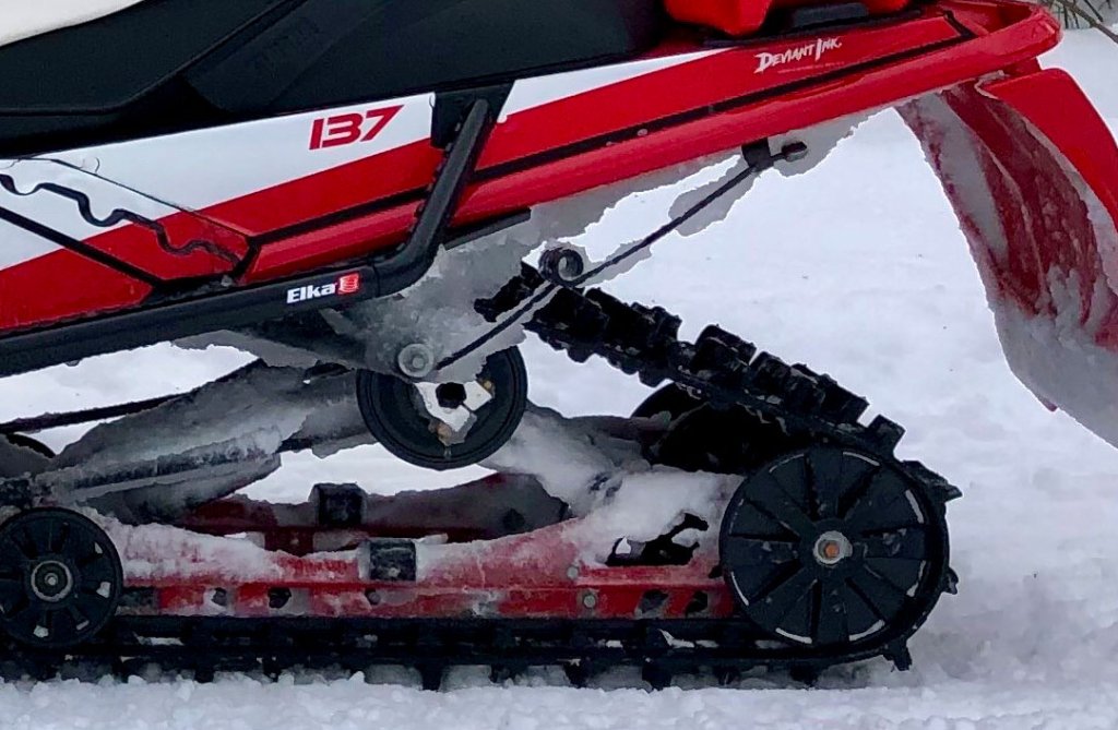

I really like these BRP ones. They mount right up to where the bolts are for your skid. What I like most is you can just reach down to lower them or hang them back up without ever getting off your sled. Makes it easy for a quick stop and go if you need to use them or want to hang them back up. I've been running them the last two seasons and love them. Plus, no dings in the rails which is nice. All my Doo friends run them on theirs. I saw on some forum how easy they are to mount on the Viper/Sidewinder chassis, so I thought I would give them a try. Work awesome...plus you can go in reverse.

No, you have to replace the stock mounting bolt. I purchased 90mm ones in order to be the correct length. The bolt that comes with the ice scratchers are too long, as I believe they were 110mm and would hit the upper idler wheels.

Kinda agree with eightpilot. I’ve had them on my winder since I owned it and honestly the number of times I’ve needed them ain’t many. Like someone above mentioned I mounted mine thru one of the cutouts in the rail with an aluminum plate on each side of the rail and a spacer in the cut out so when I tighten the bolt on the inside of the rail it doesn’t crush the aluminum on the outside plate. In the rail there are also some predrilled holes and a quarter inch eyebolt fit perfectly without drilling. Never had an issue with one contacting track.

This is the set up I am going with next season!I really like these BRP ones. They mount right up to where the bolts are for your skid. What I like most is you can just reach down to lower them or hang them back up without ever getting off your sled. Makes it easy for a quick stop and go if you need to use them or want to hang them back up. I've been running them the last two seasons and love them. Plus, no dings in the rails which is nice. All my Doo friends run them on theirs. I saw on some forum how easy they are to mount on the Viper/Sidewinder chassis, so I thought I would give them a try. Work awesome...plus you can go in reverse.
