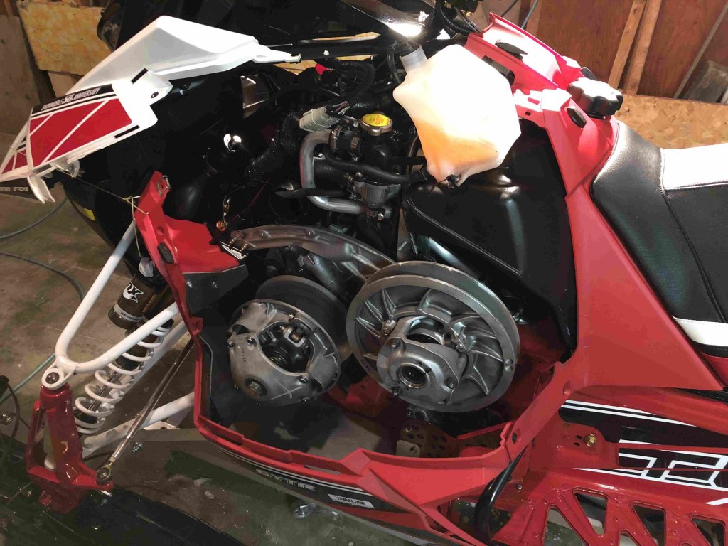

Clutch Offset Part 1
Mine stock has one shim behind secondary. Offset measured approx 62.5mm. Lots of belt dust with stock 8jp.
I wanted to eye mine up for peace of mind. And with these sleds you must remove the belt guard, so its abit of work but was worth it for me to make sure how the belt runs.
It was a tad out by eye, at this spec.....Video below.
**Lowered the offset to 59mm, aiming for better belt life**

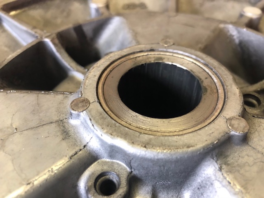

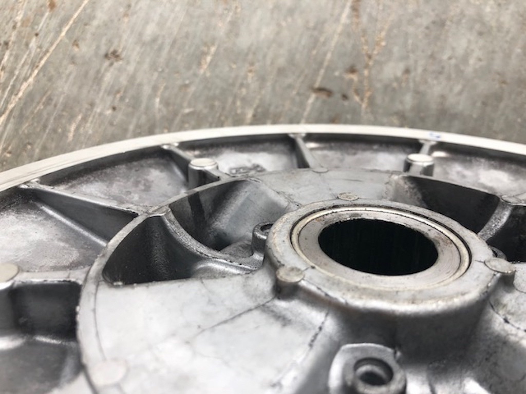

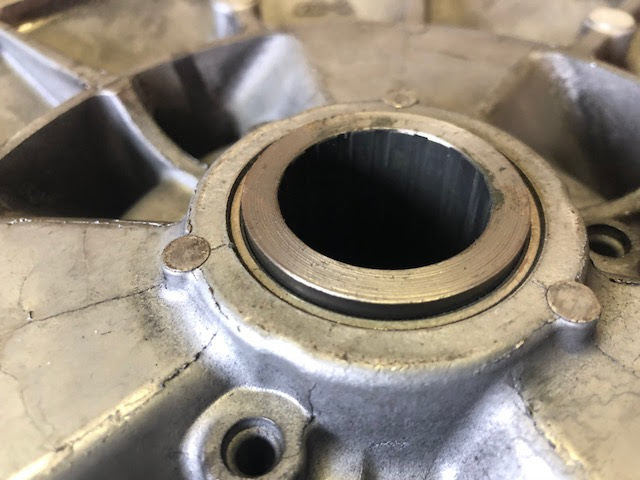

Clutch Offset part 2 - 59mm
Got my secondary back from my machinist.....
Had him take off 4mm off rear of hub, which makes it just a tad past flush when full shifted. And then I had him make me 3 shims, that are a slightly smaller OD then stock YAM shims, So they don't rub. This way I can shim it wherever I want, and it will allow the shim to go inside if need be.
I had him make me a 2mm, 1.5mm, 1mm, shown in pic below....and then the stock 1mm which is larger OD.
I am now able to put my clutch anywhere from 58mm on up to 61. Where mine sits, I use the 1.5mm and end up right around 58.8mm or just under 59mm. Which I think is where I will put it now.
Remove spring, open fully
Stock, approx 3.8mm sticking out when max open without spring.
Take apart and take for machining
After machining off 4mm, just a tad past flush when opened fully.
Custom made(smaller OD) 2mm, 1.5mm, 1mm and the larger OD stock 1mm

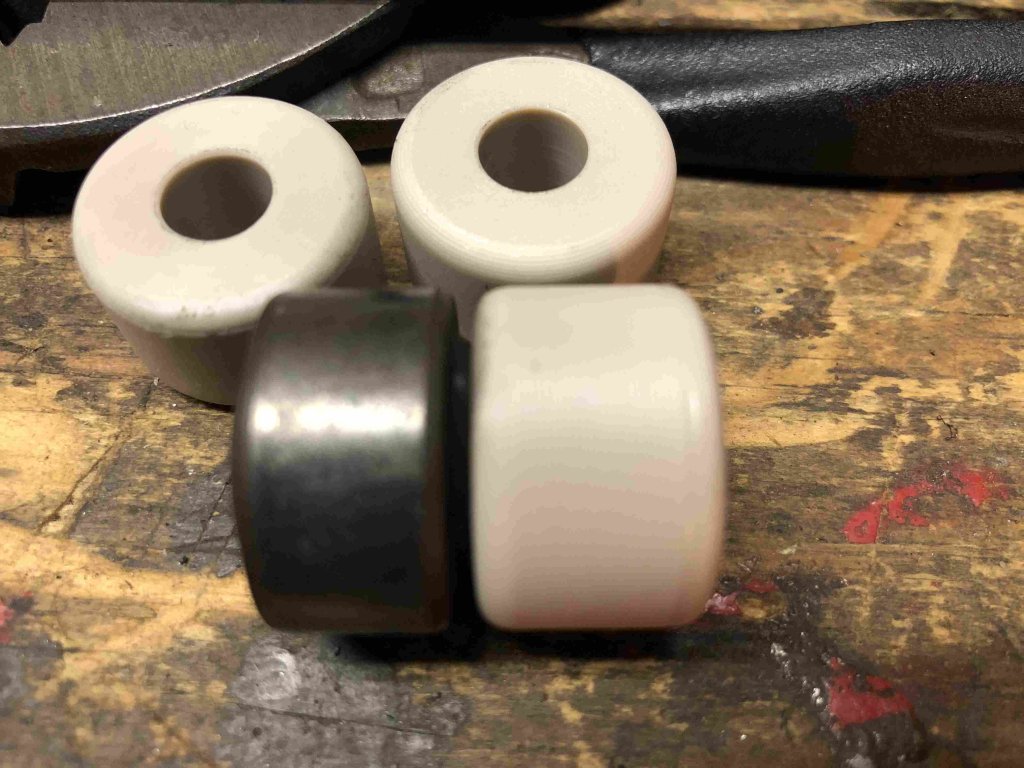

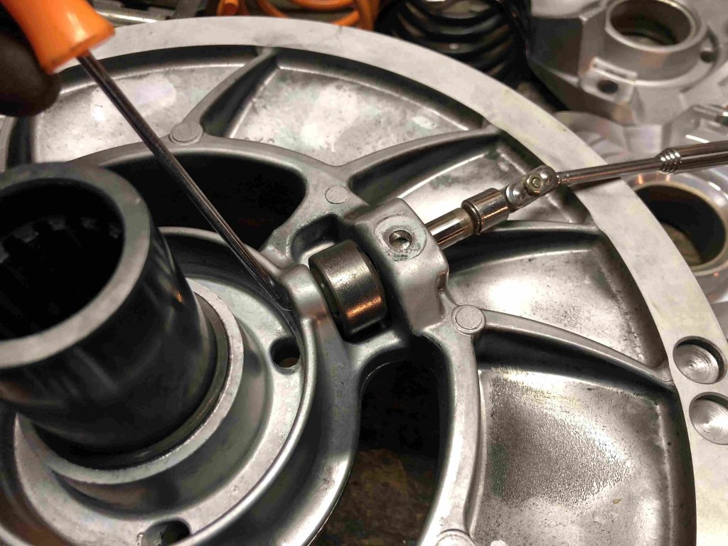

Clutching: Secondary spring, Rollers, Helix (See Updates)
Wanted to start with one clutching aspect. I am going to do one thing at a time with this sled. Power wise, remaining stock for now.
I have felt the biggest bang will be with replacing the stock secondary spring. And I think this likely could be single biggest thing that is lacking on the winder. Now that we have a couple choices, this yr will be alot better then last season. The stock secondary spring is so whimpy next to the stout TP orange. UPDATE: Must be careful to set the TP Orange to a lesser degree setting, as its a stout spring. I recommend contacting Terry at ThunderProducts for latest info.
Im starting with the orange TP secondary spring, set to 3-3. And the Dalton helix(33/35 REVERSE ANGLE). And OSP rollers, which im really glad I decided to do even if the new 18 rollers are better, they are still far narrower. Look at the comparison pics from stock rollers to OSP Torlons. See Below in red, updates I have made.
Will post more about results, but only had a quick rip on her so far and it feels like the instant snap is increased tenfold. I will elaborate on this alot more as this is what I am hoping to get from this sled, be it clutching or tune that gets it there. The reverse angle helix works well for STOCK ENGINES, and very LOW tuned engines(225 or less IMO). As soon as I went to a tune of 240 and higher, The reverse angle is not good IMO, See updates below.
*UPDATE(Jan 25th): I have gone to a 39/35 helix as the reverse is too low for the big tunes, and therefore hard on belts. I recommend a 41/35 to a 37/35 for the early spool tunes. I also updated to BOP deflection adjuster and Hi-Torque rollers. I also like the Dalton B/O sec spring much more with a tune. The 39/35 worked really well overall on 240 and 270 maps. See updates below.
**UPDATE(Oct/2018): I will be testing a 37/35 for season 2019. Please see this newer post for info on latest helix and new B/O updated Dalton spring-LINK:https://ty4stroke.com/threads/my-rtx-le-50th-build-thread-rockerdan.149801/page-30#post-1442912

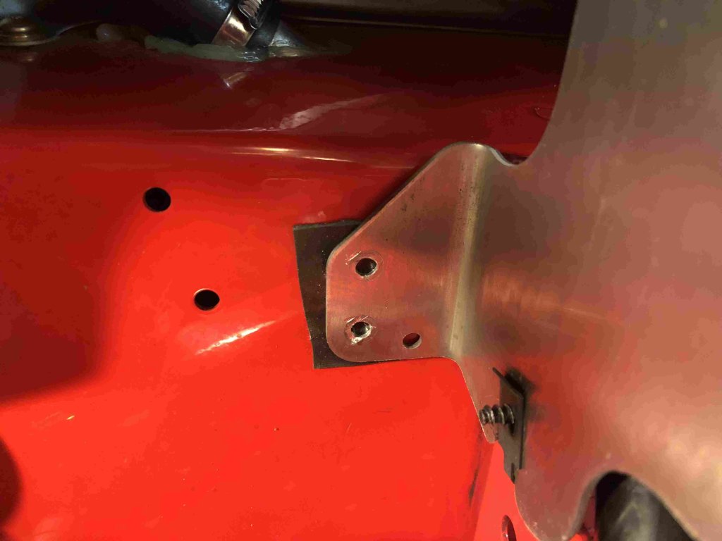

The guard is quite rigid in there with that one rear screw and the nut and then the two up front. What I did was put some 3m exterior glazing tape between the frame and guard, it covers holes and also stop any wear on powdercoat. Its a real thick two sides exterior tape that will stick in there and never move after awhile.Dan when you installed belt guard did you put rivets back in
Thanks Pan
UPDATE: I have since riveted the guard back in place since I am not needing to remove it anymore.

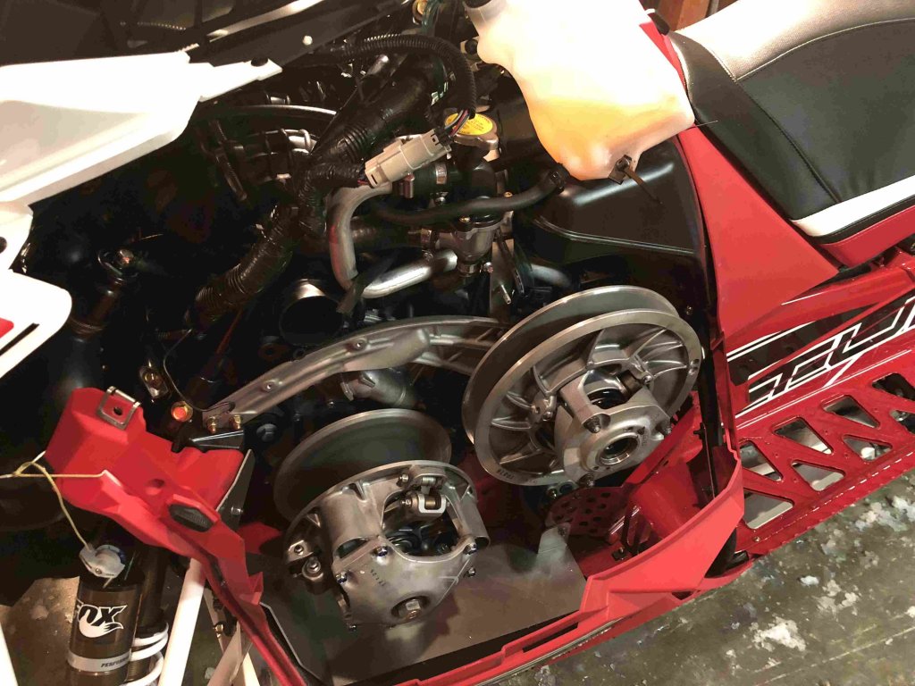

Few more pics with guard off....

Cat should have designed that clutch guard to be removable, with the pulling of a couple pins. All this NEW technology, but NO functionality.
- Oct 8, 2005
- 7,496
- 3,609
- '18 RTX 50th "Winder"
I assume with the coolant overflow tank and airbox intake, they felt it should be non removable. I think that is why they rivet it in back, so guys aren't removing them all the time.Cat should have designed that clutch guard to be removable, with the pulling of a couple pins. All this NEW technology, but NO functionality.
It sure was nice to get it all opened up at least once, to get an eye on it all...with no obstruction.

Awesome Dan so that’s what I will do alsoNope.....Not needed IMO the guard is quite rigid in there with that one rear screw and the nut and then the two up front. What I did was put some 3m exterior glazing tape between the frame and guard, it covers holes and also stop any wear on powdercoat. Its a real thick two sides exterior tape that will stick in there and never move after awhile.
View attachment 135486 View attachment 135487

Dan,
Come on, that shitt metal screw and barely hold the cheap coating on let a lone hold the guard in place if a belt explosion should happen. You got to do something different there bud. Even the factory setup is none too strong. You're just asking for trouble there should a belt let go.
