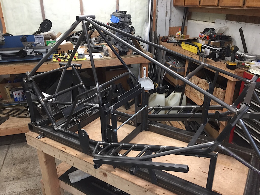

I gotta admit, the first time I saw the tubing running all the way back from the steering hoop support I thought that's gonna be awkward to ride. I'm guessing you prefer Stand-up riding to sitting (I know I do) but even so I'm wondering how comfortable you'll be straddling the frame all the time, especially since it gets wider as you move back on the sled. I really like all of the room it creates over the motor, but I wonder if the fuel tank being so tall will make the sled a bit top heavy.

Interesting ... looks like that tank incorporates an oil resevoir as well.

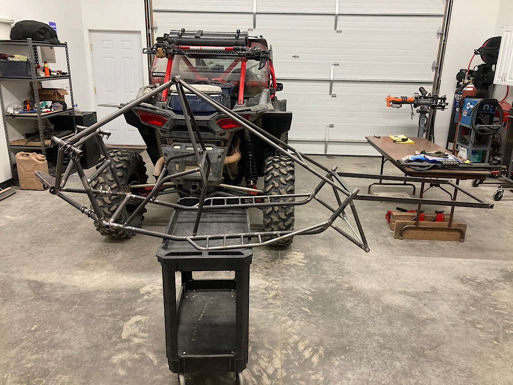

Been awhile. I’m not sure how the fuel tank is going to work out. I can always cut out those tubes if needed. I have stood on the running boards and it feels fine but actual riding is different than garage riding. I’m still not sure how much I like the rear suspension mount/bumper either but I’ll probably just weld it for now and can change it later.
All of my cleaned joints are starting to surface rust so I was forced to remove everything from the frame and I’m going to start welding it out the next few days. I need to get it welded then get the motor mounts done, chaincase mounts done and then paint it to keep it from rusting while I work on it. Here’s a few pics of everything removed.
Drivetrain came out together which was nice.

Got it pulled out of the jig today. Because I ran the tube below the a-arm mounts I had to grind the welds and remove them. I drilled 1/4” holes and put bolts in first so I could get them back in place if I ever need to. I did it very quick and crude. I had to grind a few different things out of the way on the jig to remove the chassis. I’m going to clean up the jig and then spray paint it keep it from rusting.
I don’t have a good fish scale anymore so no weight.
- I need to finish welding everything but the rear suspension mounts(still might change them)
- Weld in the forward upper a-arm tab
- Weld in 1 coolant fitting
Then I can put it back in the jig and do the motor and drivetrain plus about 20 other things.
Nikolai
Resting it nose down on my postal scale it’s 26 lbs as pictured, my calculations have been spot on. If I can stay on track then I should be under 40 lbs for a finished chassis including the tunnel skin, front tunnel enclosure, exhaust shields and seat.
