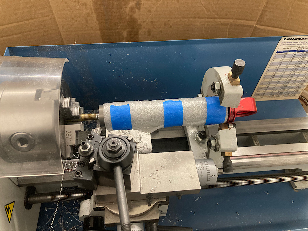

Took a shock apart tonight, not much to them.
The shaft is 1.125 solid aluminum, 7” long and weighs 0.77 lbs. I was going to make 0.60” spacers to go over the shaft to shorten the shocks but I’m going to call around and see what a machine shop will charge to just cut 0.60” off the end and drill the hole a little deeper so I can tap some more threads. The bolt that holds the valve stack is 3/8-24 threads. I really wish I had the ability to drill the shaft out somehow, there’s no reason that needs to be solid aluminum, you could get the shock weight way down.
Nikolai
I cut the shafts down with my bandsaw and was able to crudely rig them in my small lathe and turn them down to the correct length. Not the most accurate but it saves me some money at the machine shop. Dropping them off at a local machine shop tomorrow to have them faced flat and the holes drilled 0.50” deeper so I can tap additional threads.

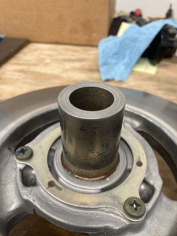

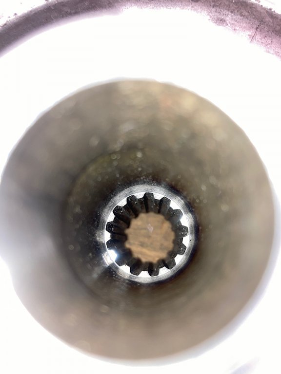

I realized something really stupid today that I did years ago. I had cut off the end of jackshaft and cut a groove to retain the gear with snap ring. But over the last few years it never occurred to me until yesterday that the Jack shaft would just lose all the chaincase fluid out the clutch side since it’s hollow. Definitely felt like an idiot last night. Thought about plugging it with a rubber plug. Then measured the ID and it’s .503 which is the perfect size for an M14x1.5 tap which is the same threads as the clutch bolt. So I’m thinking at this point I’ll just tap the jackshaft and retain the upper gear with an M14-1.5x30 bolt and use thread sealant on the bolt threads.
Couldnt you just push a Aluminum plug into there? Lighter and Snapring works so.I realized something really stupid today that I did years ago. I had cut off the end of jackshaft and cut a groove to retain the gear with snap ring. But over the last few years it never occurred to me until yesterday that the Jack shaft would just lose all the chaincase fluid out the clutch side since it’s hollow. Definitely felt like an idiot last night. Thought about plugging it with a rubber plug. Then measured the ID and it’s .503 which is the perfect size for an M14x1.5 tap which is the same threads as the clutch bolt. So I’m thinking at this point I’ll just tap the jackshaft and retain the upper gear with an M14-1.5x30 bolt and use thread sealant on the bolt threads.
Nikolai
I could, that’s a good idea and easy to do. I’ve been wondering the last few days if the snap ring would be strong enough? I don’t think there should be much lateral force on the snap ring. Shouldn’t be any from the gear, maybe only from the secondary clutch opening?

Part number for that rubber fitting is 82M-17699-00-00This is jackshaft from 97-04 two strokes.
Nikolai
Thanks! That’s an easy fix.Part number for that rubber fitting is 82M-17699-00-00
