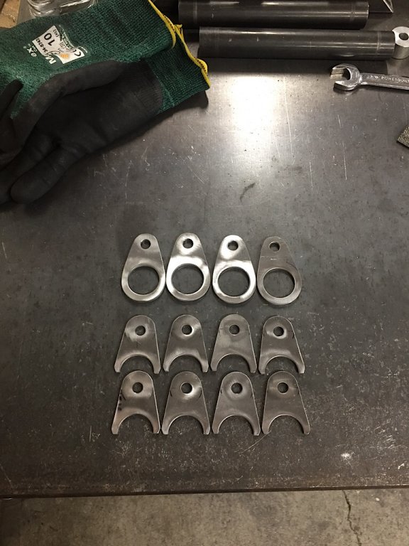

4 shock & 8 a-arm tabs
Jigged & ready to weld

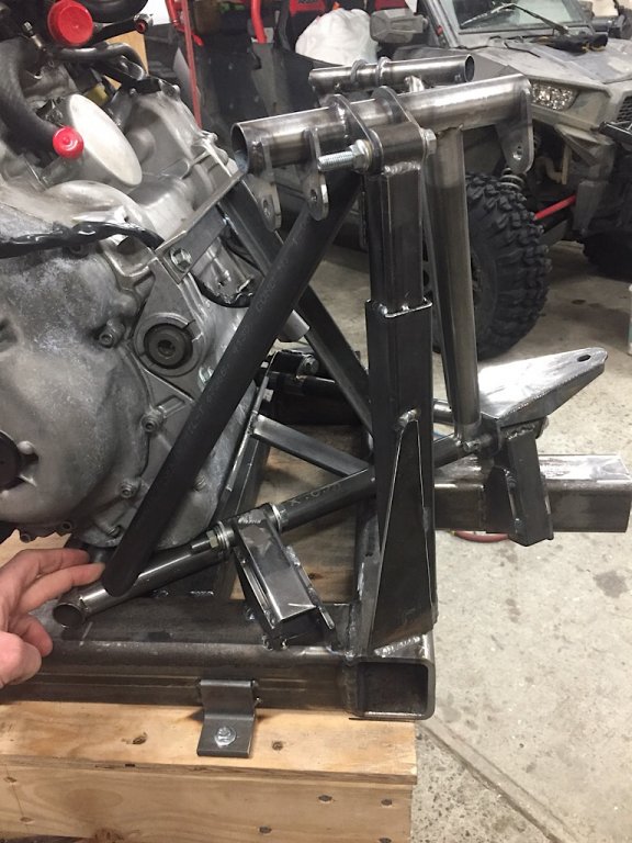

Got one a-arm/shock mount tacked and in place. It ended up in a slightly different position than I had pictured in my head. Going to have to modify my plan for the tube work a little.

Made some progress and spent some time undoing some work as well. I spent today working on the front tubes which are .035. I’m using a mix of .035, .049 & .058 depending on what the tube is supporting. Trying my hardest to keep the weight down.
Started by welding the tops of the lower tubes since they’ll be covered by the upper tubes.
Got the Mag side front tube fit. I ran it as far into the steering mount as I could to get the largest welding area for support.
As soon as I got that tube in place I realized one of the a-arm tabs would be in the way. I want every tube on this chassis to be 100% fully welded so water cannot get in. I also will not be putting any holes in the tubes. When I cut apart my Nytro frame I had water and rust inside some of the tubes from putting rivets in them and a few weren’t fully welded. That was an eye opener and I don’t want this chassis rusting from the inside out.
So I had to grind the tack welds & remove the a-arm tab. Once I tack the tube in place, I’ll remove the a-arm tab(it’s just in place to help position the tube), weld the tube, then tack the a-arm tab back in place.
I also had to cut off part of the rear shock mount tabs as they’ll be in the way of the tubes that go down towards the rear.
Now that I’m done undoing work, I will fully weld what’s left of the shock mount tubes and bolt them in place, finish tack welding the front .035 tubes, then fit and tack the rear .049 tubes in place.
I know my posts are long but I’m hoping that they’ll save someone else some hassle if they decide to build a tube chassis.
