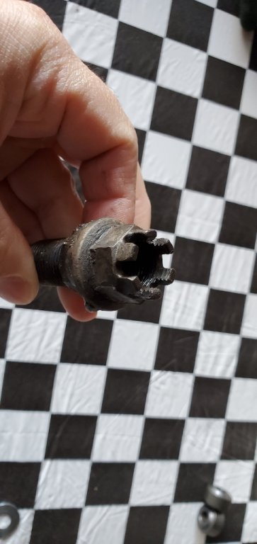

Well, after a plane cancellation, spending an extra night in Mexico and finally making it home, I picked up my clutch. Check out this puller! He did just like what was suggested and used his 20lbs slide hammer.
I don't have a welder or a slide hammer so this was worth it.
Stub shaft seems good no issues. I see the bearing isn't fully seated so I will ensure all that is good before I re-assemble.

Wow, that thing folded up like a cheap lawn chair.Well, after a plane cancellation, spending an extra night in Mexico and finally making it home, I picked up my clutch. Check out this puller! He did just like what was suggested and used his 20lbs slide hammer.

Wow glad it worked out.....
Hey what brand puller was that? Hopefully not EPI?

I will have to check if the brand is on the paper I have from it. I bought from a local parts shop, likely some kind of generic one. Just glad it's all apart!Wow glad it worked out.....

As the old saying goes ... you get what you pay for. Glad they got it apart for ya.I will have to check if the brand is on the paper I have from it. I bought from a local parts shop, likely some kind of generic one. Just glad it's all apart!

Yup cheaper puller. Same thing happened to me. Freaked me out. Bought a strong puller and it was fine.
