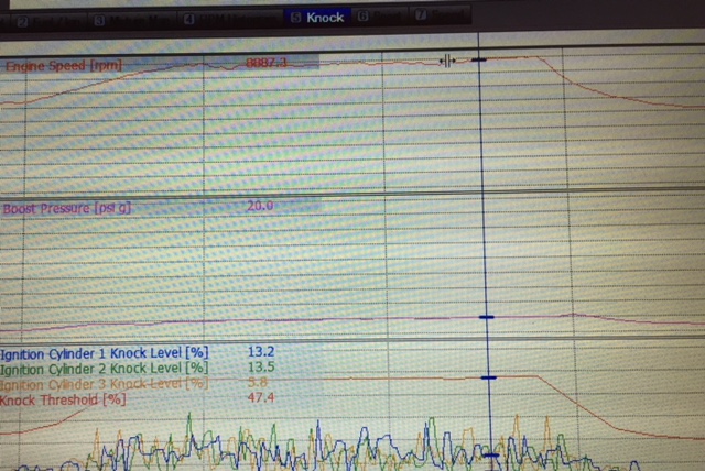

I was surprised at the boost levels we can achieve on pump gas and Lucas additive using the motec with closed loop control. With recent adjustments it’s running over 20psi with clean log file (zero knock). See pic above.
The clutching is identical for both, DTAY-1, dalton B/G primary. Stock helix with Dalton B/O at 60. After turning it up a bit, the Motec sled runs max weight at 81 grams @ 9200 at 21psi (pump gas/Lucas and clean log file). 11.9 AFR. Not going to push it further this year.

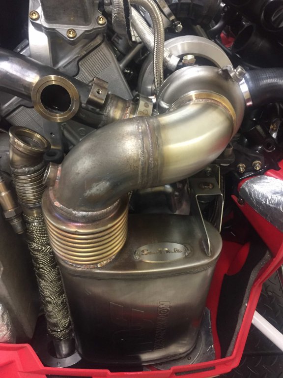

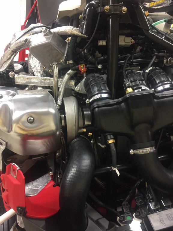

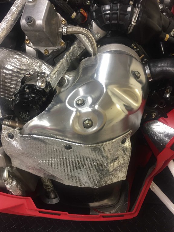

Here's a few pics of the new turbo install. This will be my pump gas trail sled for the season, hopefully it will be close in performance to the old motec doo? Pleased how it came together, it's mounted in the same place as stock turbo. Just had to cut a new hole for the divorced waste gate and a bit of trimming on the heat shields. The turbo is a Xona Rotor with a HTZ wheel. The exhaust is a modified Sandale to accept a V-band clamp. Completely removed the roll over valve and vented the
crankcase pressure to a catch can. Precision Sport's designed the kit and in typical Martin style, it's first class!

Martin tuning it? Looks sick BTW
ktmhk53
Suspended
- Jul 4, 2006
- 64
- 20
- 688
Please, details, we need details!!!
