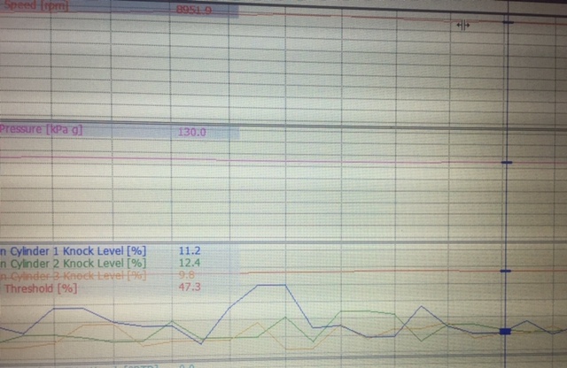

Testing went well today. Ended up finding pump gas limit is 19psi measured after the throttle bodies. This equates to 20.5 psi when reading at the boost box.How did your weekend test go with the sled?
Rpm curve is very flat at 8900. The helix change eliminated the over rev I was dealing with. Clutching is 41-37 helix, black orange at 6 X 1. Black green primary with dyta-3 set at 90.5 grams.
Went through a half a tank of fuel testing today, pushed it hard and no issues. Ready for the trails....assuming it snows!!
68gmc
View attachment 143973 View attachment 143974
Really nice setup. I see the knock levels are certainly pushing the limits of the fuel octane. Are you running straight 91 or with some Lucas additive as well.
Judging by your clutching parts and rpm you are making great power, well beyond what the stock turbo and any tune can support on pump for sure!
Looking at working towards a similar setup for my winder. Currently maxed out at 18psi with a cold air intake and header on straight 91 pump with stock turbo.
