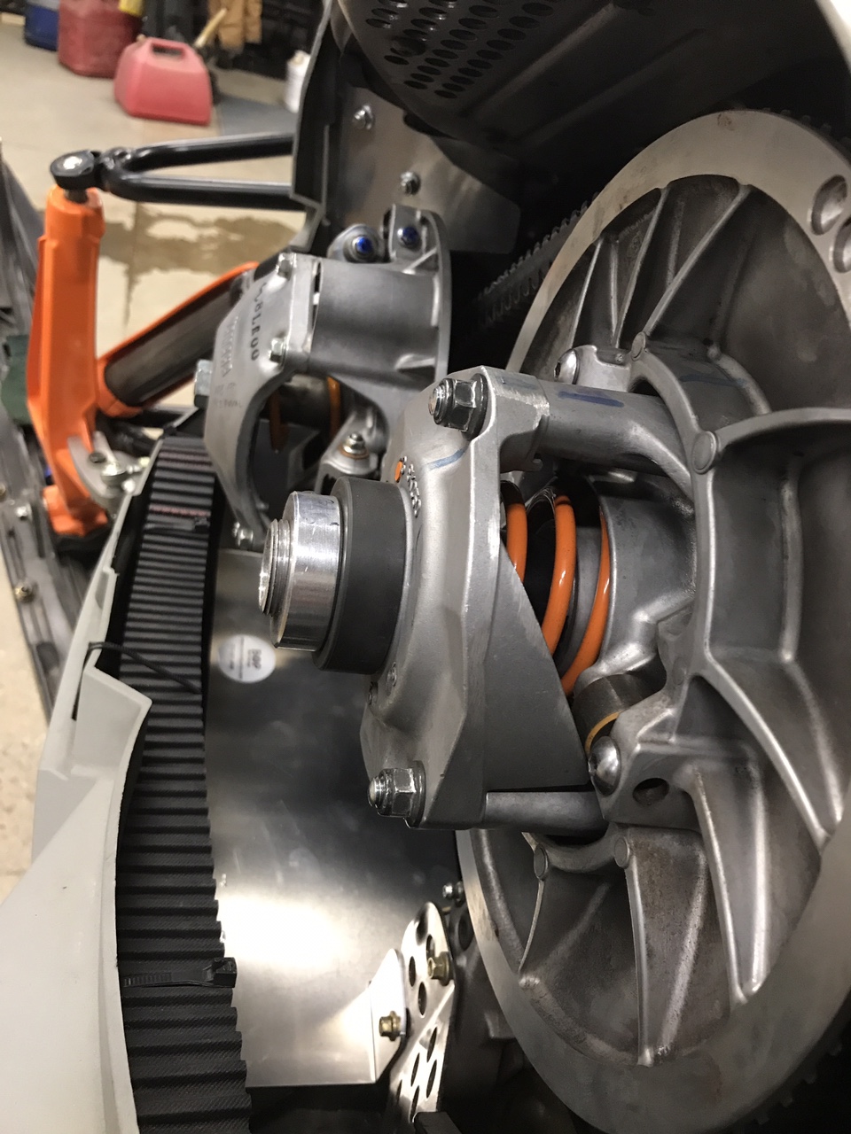

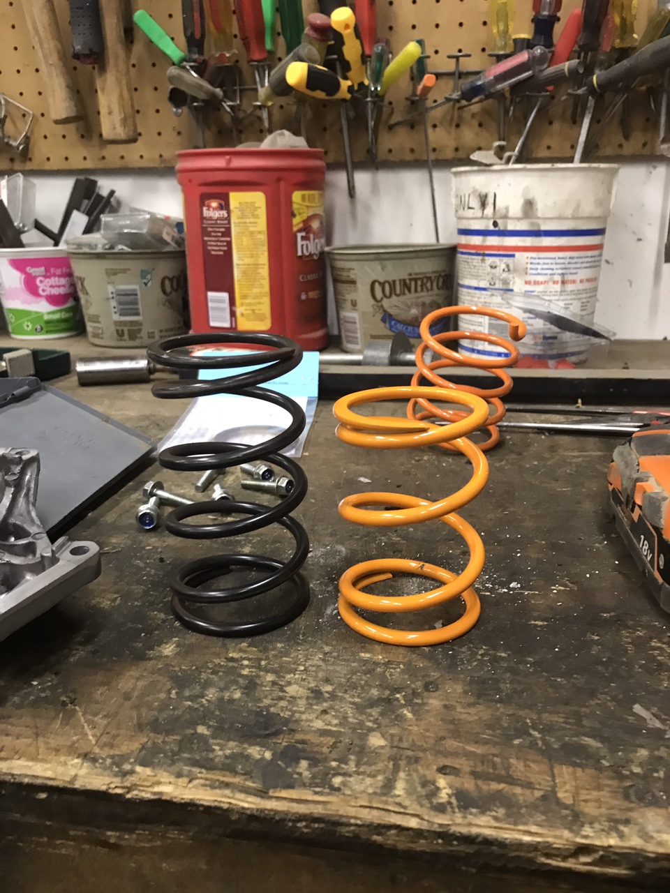

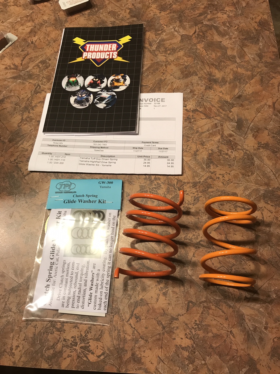

Huh, I just installed both orange springs and I talked to lonn on the phone and he didn't say anything about it not working with stock weights. He said that the oem spring wasn't consistent and there was coil bind, there spring is shorter to eliminate that. I also put in glide washers.

Your engagement will most likely be pretty low, but you might like it.Huh, I just installed both orange springs and I talked to lonn on the phone and he didn't say anything about it not working with stock weights. He said that the oem spring wasn't consistent and there was coil bind, there spring is shorter to eliminate that. I also put in glide washers.

silveram...not sure because i have old eyes for close work...but do I see a flat spot on a roller?
No. They are cat rollers.

I gave them a full inspection and clean up when I installed the new springs and Glide washers.
