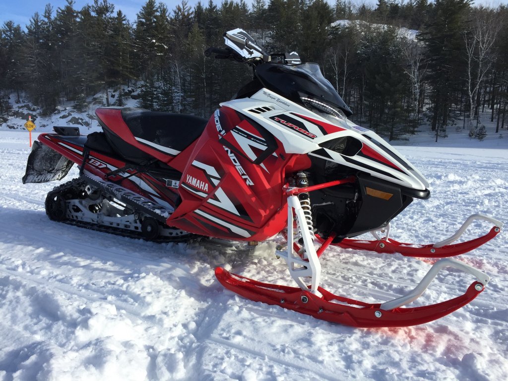

I started adding up the costs for me to rebuild a new one same way...man its a schitt-t0n of green backs! Yeah still 3 more yrs warranty I got too.All good, keep it another year, it's not even broken in yet! Still has warranty and a ton of goodies. And looks almost as good as my 17 haha!!
