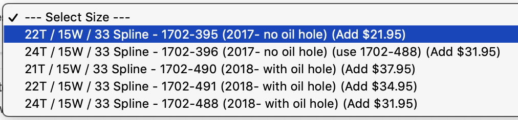

I ended up throwing my old gear in for the rest of the season. I will research this bushing and address at next fall's teardown.

New gear every 1500-2000 miles imo....dirt cheap 13$usd typical.

Exactly!! Retail on that gear is $52.99 and last time I ordered one it took 3 weeks.

I switched my oil from 70/90 amzoil synthetic to synthetic automatic trans fluid after my top bushing was down to the copper bushing after 800 miles . Just checked bushing still looks perfect after 800 miles trip . I'm heading out next week to upper Michigan for more miles will check after , but it's better than with 70/90 oil ...

I've been using using Royal Purple 75W140 in the SW for 9000kms and the Viper for 6600kms and both gears look great. I overfill the case a bit also.I switched my oil from 70/90 amzoil synthetic to synthetic automatic trans fluid after my top bushing was down to the copper bushing after 800 miles . Just checked bushing still looks perfect after 800 miles trip . I'm heading out next week to upper Michigan for more miles will check after , but it's better than with 70/90 oil ...

Cat country had 22T with holes for around $40Exactly!! Retail on that gear is $52.99 and last time I ordered one it took 3 weeks.

I got this part number(1702-395) for $13.95 two seasons ago. I see they have gone up a tad but still cheaper then a tank of gas so well worth installing new every season IMO.
I know mine looks decent but will install new in fall.
