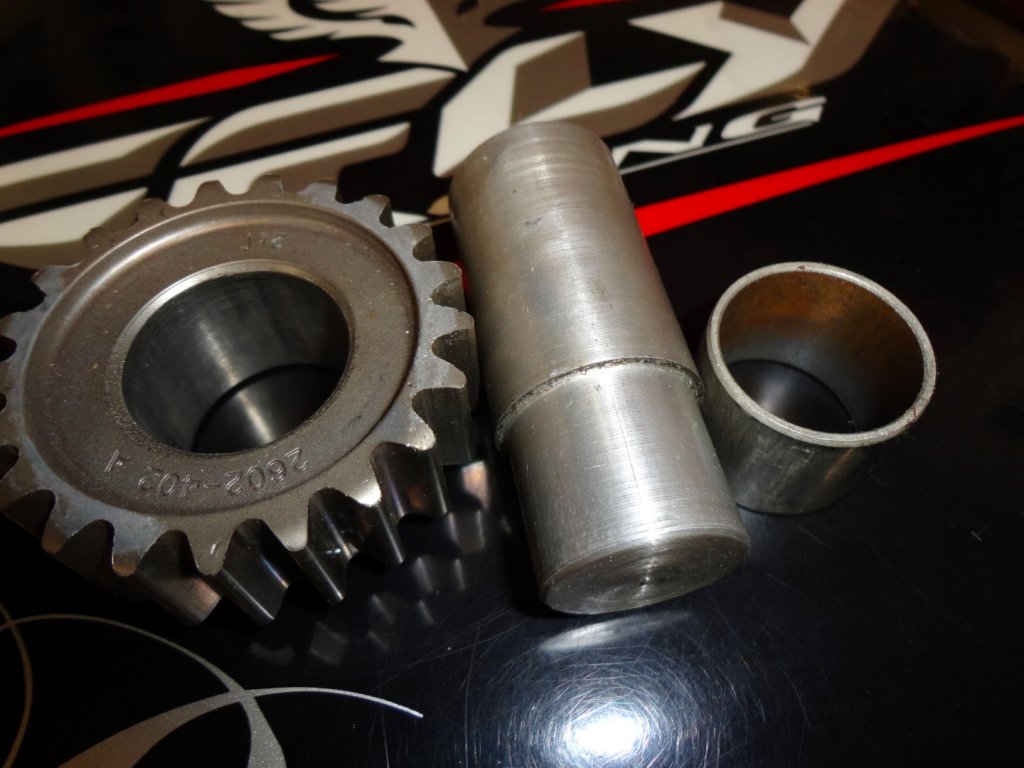

My Scott Taylor bushing only lasted one season just like stock and costed more than a whole stock cheap gear which is reason I have been buying a stock gear and reusing the bushing since. 5 years 5 bushings. Takes ten minutes at most to push it out and replace.

I heard Ulmer is selling a new oillite busing for the top gear.
That would be better than stock for sure. Anyone test it?I heard Ulmer is selling a new oillite busing for the top gear.
Not that I’m aware. Kevin at Port Yamaha told me about it.
