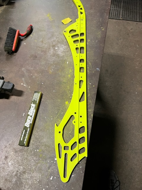

Hand sanding these rails is kicking my rear. Time consuming to say the least.
About got one side of one rail done. When I did the 153 rails on my Viper, all I did was get them flat and dull and the paint stuck without issue. That was painting them black over black, I hope this covers and sticks because I would hate to see this yellow pop thru.
These things don’t fit in my blast cabinet and I know I can’t use my blasting pot with baking soda. I doubt soda would take this powder coating off. I’m having a hard time with new media in my cabinet on the other parts. Back to work, not gonna get done by itself.

I would send them out and get them powder coated. They will strip them down and refinish whatever color you want. Much more durable than paintHand sanding these rails is kicking my rear. Time consuming to say the least.
