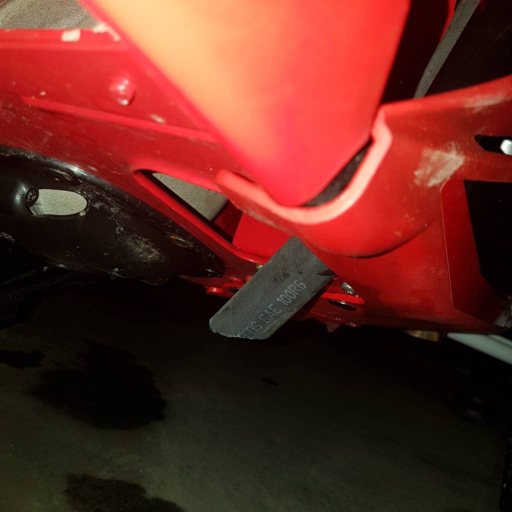

I am going to use airoquip #FCU 1206 starlite hose to vent the tank. It's lightweight, flexible, heat and petroleum resistant but a little expensive. I would like to dump into the muffler outlet at a bit of a angle to help siphon out air. It shouldn't freeze shut anyway. Any thoughts on this?Had a mechanic buddy who works on race cars drop off some some heavy duty hose that was lying around the shop. It's universal and resistant to oil and several fuel types. It's slightly larger in diameter and holds a more than enough pressure than the 5/8 inch heater hose I had on it that deteriorated and leaked everywhere. I'm hoping this is the final round. I'll be testing it out in Quebec this weekend.![]()

Dumping oil vapours into red hot exhaust stream seems like a recipe for a fire to me....At the very least the hose will melt.I am going to use airoquip #FCU 1206 starlite hose to vent the tank. It's lightweight, flexible, heat and petroleum resistant but a little expensive. I would like to dump into the muffler outlet at a bit of a angle to help siphon out air. It shouldn't freeze shut anyway. Any thoughts on this?

Did it on my race cars all the time. Had a check valve at the header collector. Crankcase ventilation at WOT.Dumping oil vapours into red hot exhaust stream seems like a recipe for a fire to me....At the very least the hose will melt.

Do these engines have that much blow by? I'm new to the 4s world so it's a honest question. I didn't think the muffler outlet would be glowing hot. The hose I mentioned is pretty good stuff, racecars commonly vent into the exhaust. You're probably right though.Dumping oil vapours into red hot exhaust stream seems like a recipe for a fire to me....At the very least the hose will melt.

Mine dumps out just behind the muffler(lots of pics around here) near right toe. And I often think about it when lake running. These turbos spit out alot more heat then a NA sled IMO. Not too mention the odd flames here and there. It wouldn't take much to ignite IMO.Do these engines have that much blow by? I'm new to the 4s world so it's a honest question. I didn't think the muffler outlet would be glowing hot. The hose I mentioned is pretty good stuff, racecars commonly vent into the exhaust. You're probably right though.

I slit mine at a very large angle(aimed rearward) to prevent freezing of end in POW.....

What about adding a slit to the hose on the inside Incase it does freeeze up?

Yes mine also has a slit for failsafe but has never plugged up with the long cut at end. Most of this is all within this thread from last season.What about adding a slit to the hose on the inside Incase it does freeeze up?

Oil doesn't ignite very easy , unless really hot or satchurated with gas . Even then it burns slow . Older cars have crankcase pressure ( blow by ) dumping into the headers .Dumping oil vapours into red hot exhaust stream seems like a recipe for a fire to me....At the very least the hose will melt.
