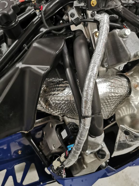

I may do something like this.Tired of getting oil in the intake, so I'm definitely bypassing it. But I will keep my heated ROV, since I'm actively throwing it around as a 2-stroke. If the hose before ROV freezes, then I'm deleting the ROV and installing a better oil tank seal.

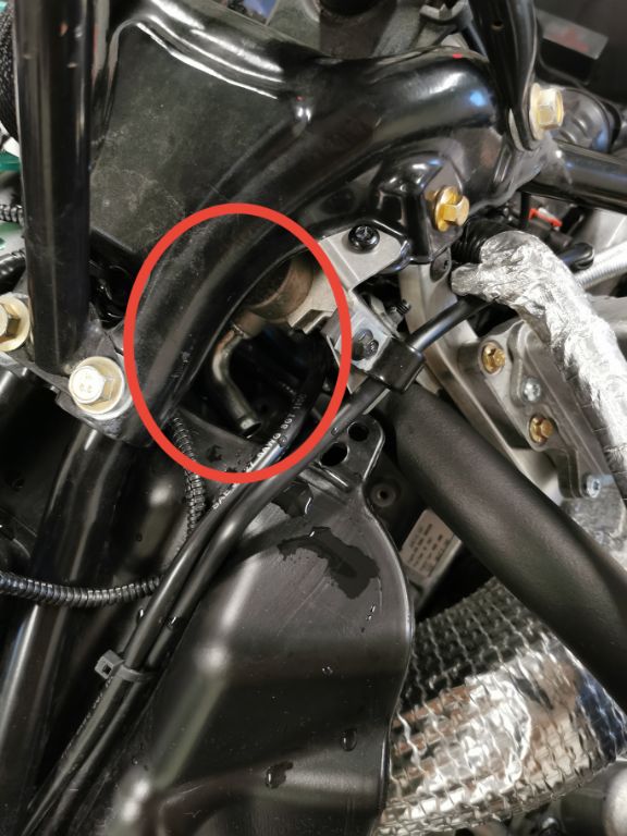

Turned the pipe towards exhaust side.
Using the original tubing, then extending with 5/8" fuel hose with angled cut and a slit as mentioned numerous times. Not gonna heat wrap it.

I meant to say oil hose, not fuel hose! I installed a gas hose that withstands high temps and is made from a substance that works well for oil. I'm thinking the original ROV won't fail. Btw it took a lot of force to turn the hose connector towards exhaust but definitely possible.I may do something like this.
