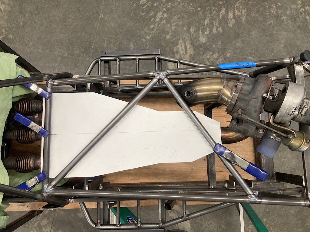

Made up a quick template. About 1/2” wider than the outside edge of the header. I think that would be enough shield and the rest could be CF. The fuel tank will end before the turbo so the there will just be a bent up shield around the turbo. I have .040 and .050 aluminum. Would have to buy titanium if I used that.
Just enough lip on the front to secure the flex joint cover to and have decent access to the clamp bolts.
Any thoughts?
Would aluminum would be adequate protection for the fuel tank?
Width of shield seem ok?
Better ideas?
Any thoughts?
Better ideas?

Another option slightly larger with less angles.
Clearance to header below fuel tank

That shield will be fine for heat protection of tank for sure. Can always enclose tunnel under pipes with CF later if needed.
