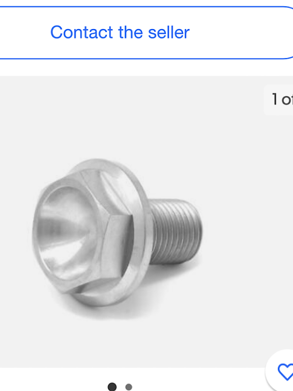

Need opinions.
I’ve always had doubts about the snap ring setup I made due to the side load from the driven clutch slamming open.
Here is what I’ve been thinking of doing. Cutting end of the shaft a fuzz shorter then the end of gear, hand tapping 14mm x 1.5 threads (same as clutch bolt) and then clamping the gear with a M14 x 1.5 x 25 Titanium motorcycle spindle bolt. Anyone see a reason that won’t work?

Im not sure how hard that shaft is?cutting it shorter with a lathe shouldn’t be an issue, just not sure how hand tapping the threads would go?maybe tap the threads on the lathe after you shorten it?otherwise seems like it would be a much stronger way to retain the gearNeed opinions.

I ordered the spindle bolt and a thread tap this morning. Going to try tapping threads in the jackshaft and see how it goes.
My lathe is too small to fit the shaft inside, bore on the chuck is only 3/4”. Threads will have to be cut by hand. My plan was to make a spacer to go over the end of the jackshaft with a hole just big enough to fit the tap to help keep it straight while tapping the first few threads.

Oh I did remember after you posted that you had a lathe but it was size limited,Will be easy enough to try it by hand & you will be able to feel how it’s threading & if it doesn’t feel right then look into getting someone to machine thread itMy lathe is too small to fit the shaft inside, bore on the chuck is only 3/4”. Threads will have to be cut by hand. My plan was to make a spacer to go over the end of the jackshaft with a hole just big enough to fit the tap to help keep it straight while tapping the first few threads.

sorry bud I got busy at work, yes I just meant if you started threading it by hand& the tap was going really hard& not cutting the threads good that you may have to do it by machine, ive had trouble in the past trying to get good threads cut by hand on really hard materials.Again im not sure how hard the shaft is but you will be able to tell if it is going ok or if its too hard of material to cut by handCan you elaborate on “doesn’t feel right”? Just if it’s really difficult or will it not cut the threads properly? Is there something specific I should be paying attention to when tapping?
We used to just tack some nuts on top of some flat stock (hole predrilled) to make a jig. The nuts already put you in a position where you know that everything is straight and well aligned. It also made the thread starts repeatable as you move the jig from piece to piece.
Nikolai
That’s a great idea, I could tack weld a nut to the end of the jackshaft. My plan was to thread it before cutting the end off anyway.

Sidewinders and Vipers just use a clip to hold gear on and my bet is you will do a much better job keeping the gears in line and Parallel than the Car factory who does them can even dream of doing in production. Leave the clip.
Nikolai
Nytro just uses a clip as well but the clutch side has the bearing pressed on the shaft that’s held in place in the bearing housing.
Factory Apex bearing setup has a taper lock that locks it to the jackshaft as well. My clutch side bearing is a regular bearing with lock ring, so in theory, the only thing resisting force when the clutch opens is the lock ring and snap ring on the gear.
Do you think that will be an issue?
I have the 14x1.5 tap & Ti bolt on the way so they’ve already been purchased but I can certainly leave the snap ring.
