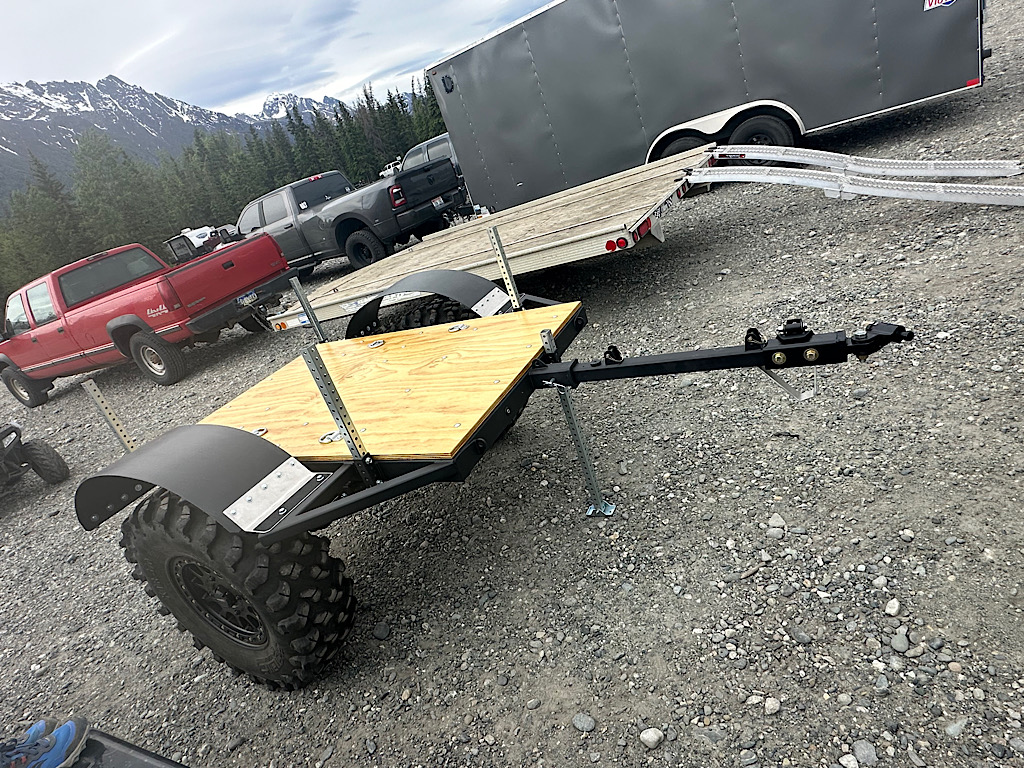

This is the trailer I spent last winter building to haul the kids ATV.

Thats cool, great job on the trailer,it looks factory built only much better quality,it fits the sidexside really well ,I need to build a trailer for my atv for hauling wood so every picture I see gives me more & different ideas,the mountains in the background aren’t so bad either!! Building memories with the kiddos love itMy focus will be on painting the frame, getting it sitting on suspension and then I need to finish fabricating the oil tank and rear cooler so I can get it running. There’s a lot of work left…turbo needs rebuilt, make a charge tube, fuel tank, body panels, ect but after the oil tank all the remaining projects will be fairly simple.
