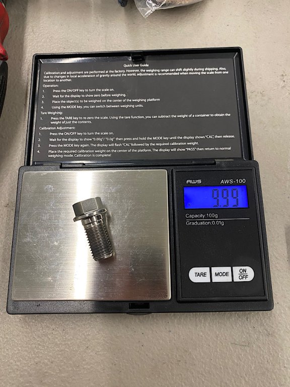

Finding all kinds of goodies. I was going through all the steering parts and forgot I had ordered a Titanium bolt for the steering post pivot tube.
3.49 lbs for the steering post, pivot tube, straps and all hardware.

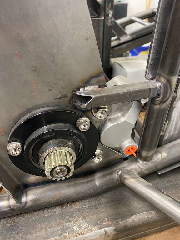

Had to grind away at the 1/2” square tube for the clutch sheave to clear when it’s open.

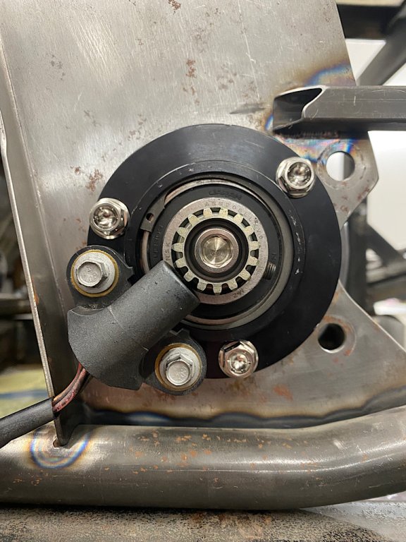

Onto the speed sensor. Got lucky and it worked out to bolt it to the bearing housing. Drilled and tapped 6mm x1.00 holes and made some hole reducer/spacers on the lathe. I might get some aluminum bolts later on.

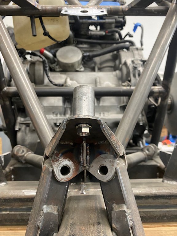

Going back over it and grinding down any brackets that can be smaller. I didn’t leave much but every ounce counts.
Currently sits at 34.4 lbs. There’s a lot I would do different in the tube layout if I built another frame. If I changed it now it would be 10 years before it gets done so I’m just going to suck it up and leave it as is. Few shots of the frame.
