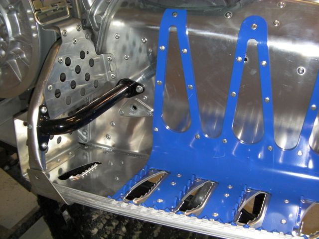

....a little trade might go on, that is what the thought holding was all about.
But anyways I got my OFT extensions so I found some time to mock them up. They looked so good raw I almost polished them instead of powder coating them.....but, I got them over to the powder coater.....and much to my surprise he got them back to me the very next day! They turned out friggin' sweet!
....sorry my camera sucks
It all looks much better in person.
It all looks much better in person.Attachments

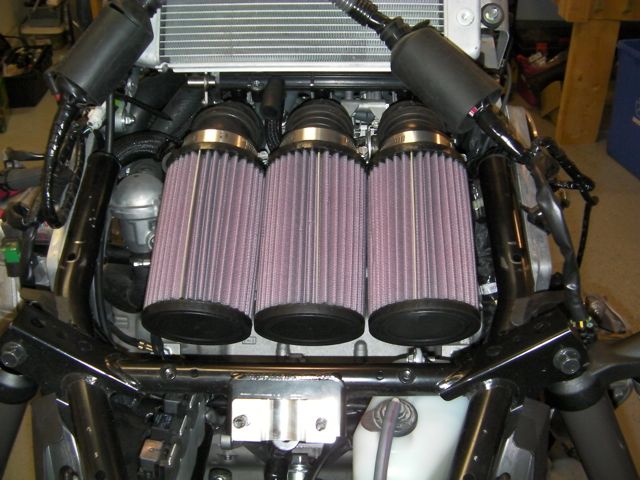

With that stuff out of the way I moved on to installing the K&N intake. Normally I hate moving backwards on a project but what can you do, I changed my mind on something and created a little bit more work.
I took the headlight off, the bars and steering post as well as the radiator shroud however when I got to the air box my night came to a halt. I could not find my 4mm ball end allen key anywhere. I tried some other allen keys and was only able to loosen one of the claps but no luck with the others....so that is that for now.
Also of note..... It was cold in the garage tonight, in fact I turned the heater on for the first time....fall is in the air!
No more work getting done this weekend, off to the lake to put the boat away.
