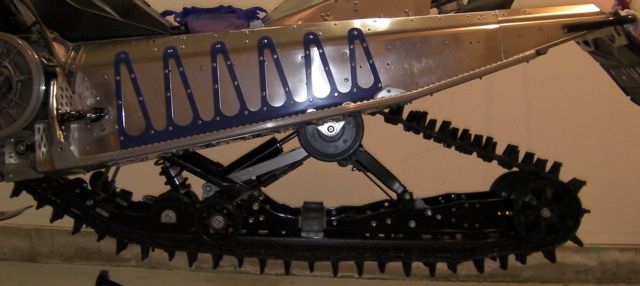

Everybody loves before and after pics right!!
Previous owner had already added the 2010 wheels. I added some to the inside, shox were rebuilt, 4th wheel added, OFT rail extensions, Yamaha high performance sliders and of course the wet black powder coat.

Ok I admit the above post is a little ......well.... cocky, I guess. I apologize I was just a little pumped at what the skid looked like when it was installed inside the freeride track.....and I love the look of those sly dog powder hounds!!
I wasted some money on the 4th wheel kit from Yamaha. My OFT extensions came with the spacers for the 4th wheel (as ordered). All I really needed was the extra wheel. THe OFT extensions also feature the same type of track tensions system that doo uses on their race sleds. Only the OFT kit is of much better quality!! The OFT extensions are the cats meow if you ask me!
All of my suspension is set up at what I think is a good starting point. I'm running 120 PSI in the float Xs as I am not running a sway bar. I also like lots of preload on the front end, nice and high!!
The shox are all set with the compression at about 75-80%.......rebound I set according to the manual as "standard" which is pretty much a neutral setting till I can get a feel for them...... unless someone can help me with a better starting point.
