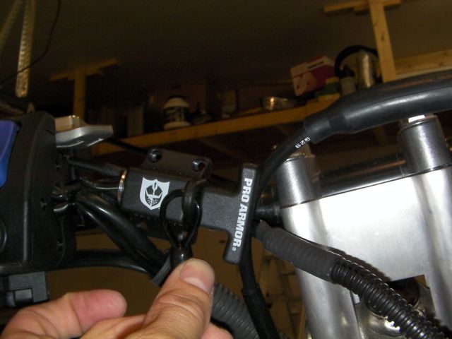

I kept my Fly bar pad from Rev. I am quite fond of it as it has save my face a few times, or at least my helmut.
The first pic shows where I was planning on mounting the Moto-R tether and the second shows the bar pad. Pretty clear to see there isn't room for both. (and I don't even have the hand guards or mountain strap on.)
I may have to switch bar bads, or maybe change bars as well.

MotoPsycho said:Stand by there for a minute Revster... we may have a cure for that issue...![]()
Pics to follow.
Sweet. Some ideas would be great. I was even looking at the steering post as a mounting point.
