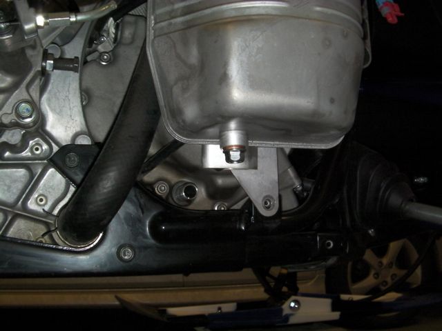

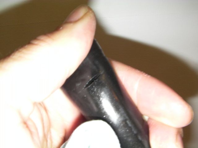

I decided to change the oil. I'm pretty sure the previous owner had done it in the spring but I had to fix a screw up that involved draining the oil anyways. The screw up was me nicking the oil line at the bottom of the oil tank when I was removing the sub frame. So I swapped that line out for a new one.

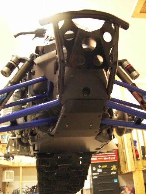

I then put the roest skid plate on which went on great! What a sweet product.
My skinz bumper on the other hand was a epic struggle to get on. The bolt holes did not line up and it took some ratchet straps and clamps to get it in position. But it's on now and it looks great.

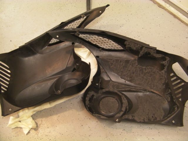

I've now moved on to the plastic. Decals are removed then the painful process of removing the foam.
Once I've pulled the foam out as best I can, I saturate what is left with goo gone. Then after letting it soak I use a plastic scraper to remove the glue and what is left of the foam. The one on the left I am done and the one of the right has the foam pulled but still needs the goo gone treatment.....
