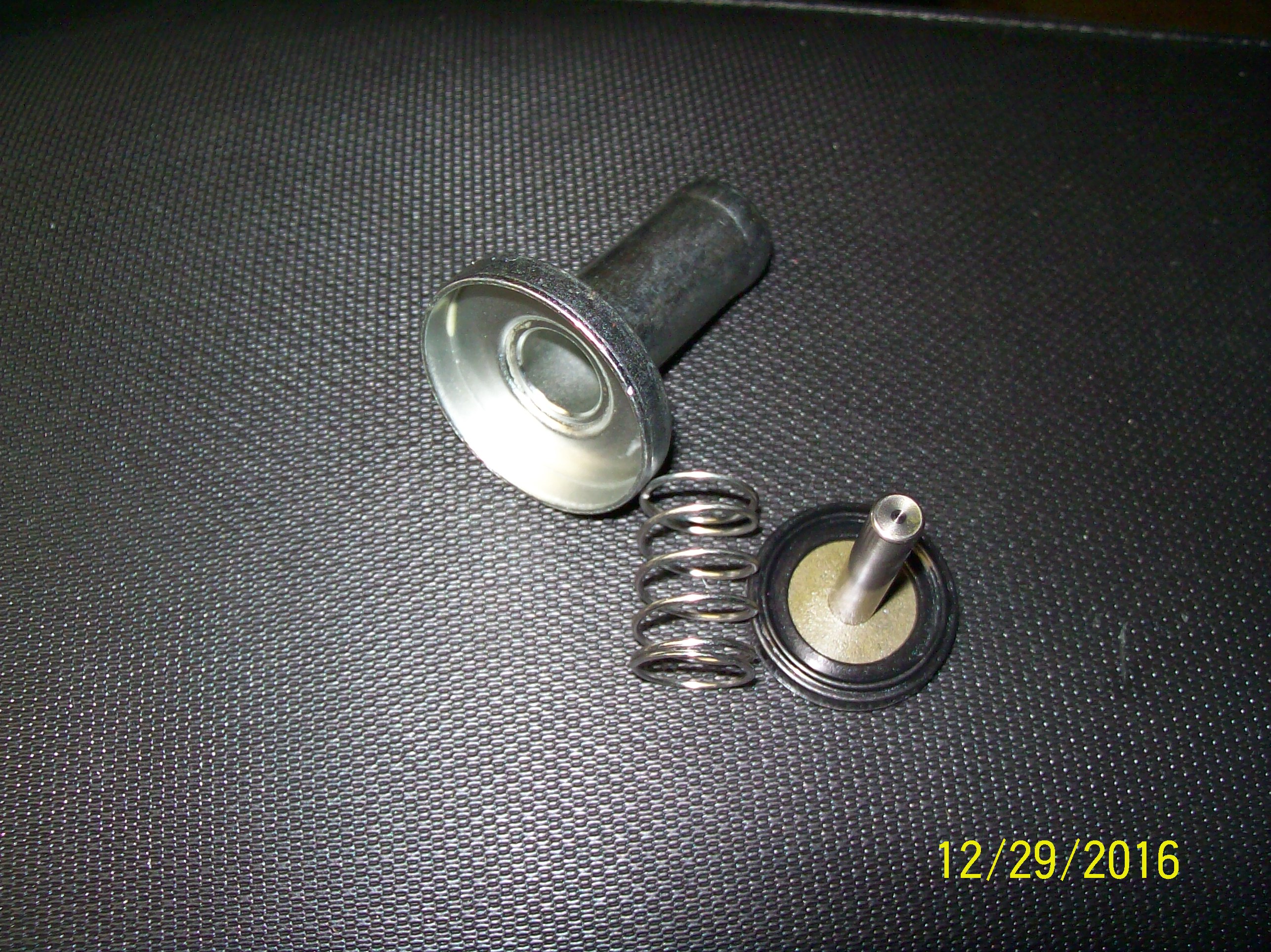

Yes I see your point for sure.Here is how it looks inside. Sounds like it's just pushed together. Joe a rollover valve such as 4strokesolutions Jacobson valve shuts oil flow off also.
I'm stuck. I don't know if I'm going to just run the valve and hope it doesn't leak again or run without a roll over valve and hope not to roll over
Hear ya. Would be nice to know what is failing in that valve. Odds are it won't happen again Joe. Would be more widespread if it was a design failure. So far it's just you and Jon we have heard from.Yes I see your point for sure.

Can we put a lesser spring into that valve? Is it easily taken apart?
It must be pretty easy since donedooinit had his fall apart when removing the hose.This is one area to be real careful though. Phazer guy had the idea of using a PCV valve and it worked but one guy had his freeze and lost a engine. So could be real touchy.Can we put a lesser spring into that valve? Is it easily taken apart?
