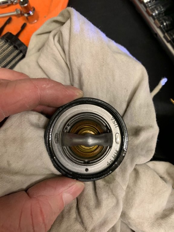

When bleeding, elevate front about 2+ feet higher than back. Idea is get heat exchangers sloped with rear-most end lowest part of sled. Then, I have thermostat side of sled higher than turbo tank side. Once I have slowly added coolant to fill system, it will eventually will start to flow out of turbo coolant tank hole (14mm bolt). Then, install and tighten bolt. Tank is full. Then continue to bleed and run engine until thermostat housing will take no more. Even then, it usually takes a few rides to get all air burped out. IMO, one key for me is I remove thermostat and drill two 3/32" holes in flat base. Stock thermostat has one tiny hole in it. I re-drill that one out to 3/32" and add another 180 deg from it. This allows coolant to circulate 100% of the time, even when warming sled up (much less chance for cold-seize type problems) AND importantly allows air to escape during bleeding operation. I can see air bubbling up through these two holes during bleeding.
that is a great idea. Done!
Stock:
Enlarged original plus added one:

Yep. That's exactly what I do!that is a great idea. Done!
Stock:
