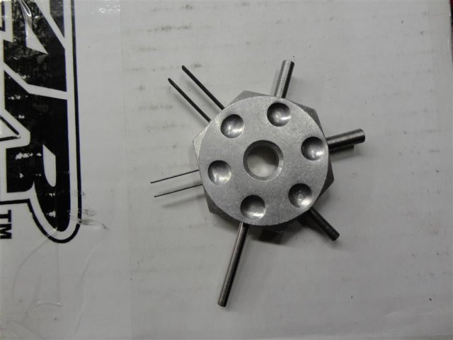

Reversed the fan wires on our red Viper to blow the air out instead of sucking steam in. Barn Of Parts is working on a hot air evacuation setup.
Yesterday was over 40 degF spent whole day doing 100mph+ pulls and riding on rivers. Very little snow on some stretches for miles. Just hard ice. With the reversed fan I never came close to overheating. Ran at 160F whenever I looked. I like the reverse fan. Doesnt help steam from powder unless fan is running so at high speed low load when engine is cool it wont help but soon as you stop fan kicks in and gets that steam out. Great idea. Heck on cold days all my buddies huddle around my radiator to warm there hands or unthaw a shield. Nice warm clean air to do it. Even better than the hot stinky exhaust coming out back of the Phazer,Nytro and other Yamahas! Great idea Stingray!
I do suggest using this tool or one like it for reversing the fan. You use the tube that has the biggest dia. Autozone or any auto store.

Can you elaborate on the fan mod please.
Reverse the wires to make fan run in opposite direction?
Yes right at the fan plug. Pull the wires out of plug using the tool and put them back in reversed.
That will work well, but I took a small screwdriver and gouged out the very small spline in the connector so I could turn it 180 degrees and plug back in.....just in case I wanted to reverse the process on the mountain. But, as it has worked flawlessly for me I cannot imagine putting it back.
