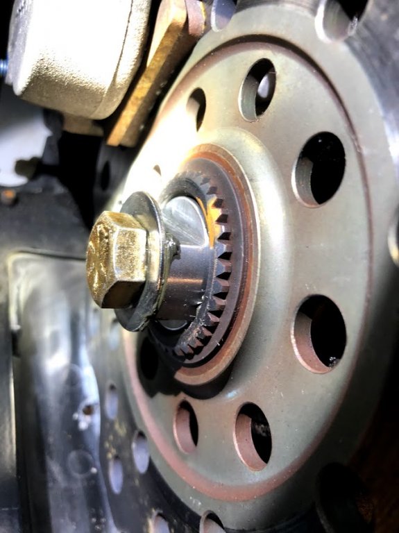

I was just gonna say- the guys getting new drive shafts , warrantied or not, if you don’t lock that bearing to the shaft you are gonna be right back to the same place in another 2-4,ooo km.

I agree and my new shaft has been given the BOP treatment.I was just gonna say- the guys getting new drive shafts , warrantied or not, if you don’t lock that bearing to the shaft you are gonna be right back to the same place in another 2-4,ooo km.

I agree with above that most people are just riding this setup since 2012 with no idea there any type of issues. And honestly I think it shows how much of a none issue, the issue is lol. Now with that being said I plan to buy the BOP kit when I do a track swap after this coming season.

I have a 19 cat and it's no different then yamaha!!! Mine did spin on shaft but I caught it early enough and add bearing retainerCurious why this issue isn't discussed in any Cat forums ? Same components .... maybe the Cats assembled with Loctite.......... or not as prevalent of an issue with the Cats ???

Just swapped drivers on a 2012 with 7000 miles , original shaft is still fine. I never use green loctite but that would defiantly solve the problem but be a SOB to get back apart. Find dimpling the shaft to work very good yet still able to remove without cursing and swearing excessively.

It's a NON-ISSUE until you take a week off and ride your buddies back up 600 Indy for 4 days.
When my sled had it's under tunnel hose leak & my buds' top gear go bad, we went to the Yamaha dealer & there were 2 Cats & a Yamacat in the shop for bad bearings on the drive shaft.
All 5 of us were on week long vacations waiting for our sleds to be fixed.
I looked at a dozen or so ProCross chassis on the trails & ALL of them had rust under the brake with 3 of them making serious grinding noises.
I'm not sure how 8 downed sleds in ONE week measure up to a "Non-issue"
BTW: I now have BOP tunnel protectors and a Shaft-McWedgy Thingy

In our group 3 of us spring ordered 18 Turbo's. One was a Thundercat and the other 2 were winders. So far both winders had the top gear bushing fail but the thundercat just had the drive shaft replaced. Everything is the same on these sleds and the wear is no different no matter who's sticker is placed on it.My thoughts exactly. They're built in the same plant, right? ProCross chassis is a ProCross chassis.
Subject has never even come up on ArcticChat. Many sleds well over 10,000 miles and all is good.
I have a feeling the spinning drive shaft is more isolated than this forum portrays.
However, I did get this kit for added piece of mind. My drive shafts are fine.
One at 4500 miles, the other 2200 miles.
I may just install the kit, torque to 35tlbs, which seems to be the sweet spot, and ride. We'll see.

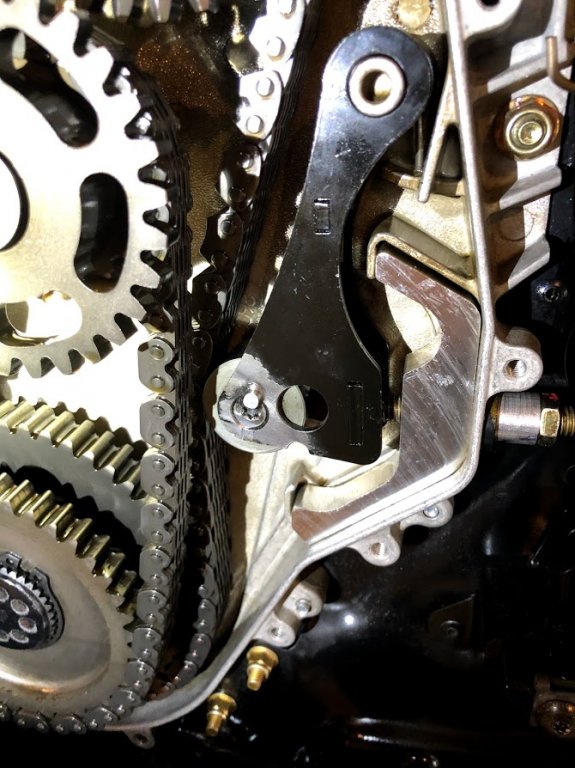

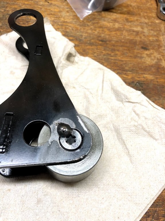

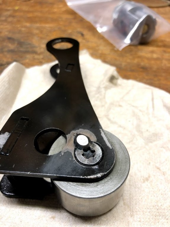

Just installed one today Travis.....Fantastic design brother!
My buds Cat will now be solid reliable this season!
Also did the tack weld mod and a few other fixes he needed.
-Oil change
-k&n oil filter
-Pennzoil Platinum 5w30
-Rivnut mod to lower side panel
-Chain lube
-Oil tank
-Roller tensioner tack weld
-Shaft Saver device
-Nickel Anti-Seize
-SS muffler bolts and lockwashers
Dan
-Oil change
-k&n oil filter
-Chain lube
-Oil tank
-Shaft Saver device
-Nickel Anti-Seize
Dan
-Oil change
-k&n oil filter
-Chain lube
-Oil tank
-Shaft Saver device
-Nickel Anti-Seize
Dan
What torque did you land on?

I ended up at 55 pounds plus a touch more
Don't forget i have 10,000 miles & this is my 4th bearing
Next year i think i will change the whole shaft
Does anyone know if Hurricanes' drive shaft has a tighter bearing tolerance?
