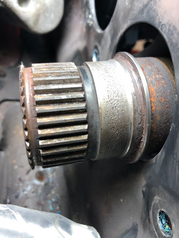

Well got me another one!
9500kms
9500kms

That’s bitched!Well got me another one!View attachment 150383
9500kms
RAMSOMAIR
Yep. Had it apart last fall and re-packed the bearing and peened the shaft. It was not bad at all. 5000kms later it is toast big time. .050 under the bearing diameter. It still has warranty left but I don't trust the dealer with it. I have a new bearing, used axle (600 miles) and a BOP saver. Might go this route or I have to re-assemble it all and throw the skid back in to take it to dealer. Who will likely screw something up and lean snow shovels against my sled (don't ask me how I know this).
9500kms
Yikes! I have 2 good used shafts if can't get warranty.

Haha. I know the used shaft with your gizmo will work but would be nice to have all new stuff from Yamaha just don't trust anyone around my sled.
Exactly why I took mine to a machine shop myself to have fixed up. Yamaha would not have done anything but order new parts and re-assemble as it was. Sure the BOP wedgy will help in that case but to me that's not enough. Weld and machine, new bearing, BOP Wedgy then it's good.
P. S. Official name should be BOP Wedgy Thing lol
RAMSOMAIR
Oh they know all about it, just play dumb. They go to school for that lol!
