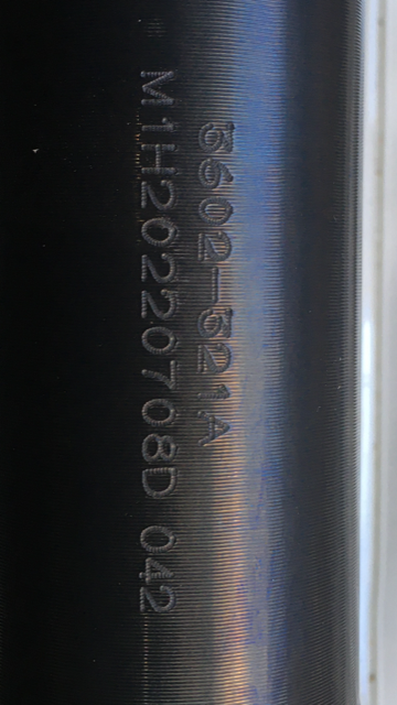

Travis, what is the Cat part number ingraved in this new test shaft?Starting in 22, driveshaft was rumored to be improved. My 22 did not appear to be, and I have seen at least one 22 shaft that was eaten up by bearing. The 23's have a new part number and all the 14-22 shafts appear to supersede to the new number. These updated -10 shafts were in stock so I had my dealer order one. I have access to some metallurgy testing at a relative's local foundry and I'm planning to have it tested to see what material the new shaft is as well as have hardness testing done. I have a junk shaft from a 17 sidewinder being tested as well so its apples to apples comparison from same lab. Will post my findings.

It's still at the lab that did the testing for me. Once i pick it up I can let you know.Travis, what is the Cat part number ingraved in this new test shaft?
I just purchased a new updated drive shaft and here is the number on shaft.

Just got a whole shaft assy. from Yamaha with that part # on the shaft. The SKF bearing I got to go on it is still a LOOSE fit.
