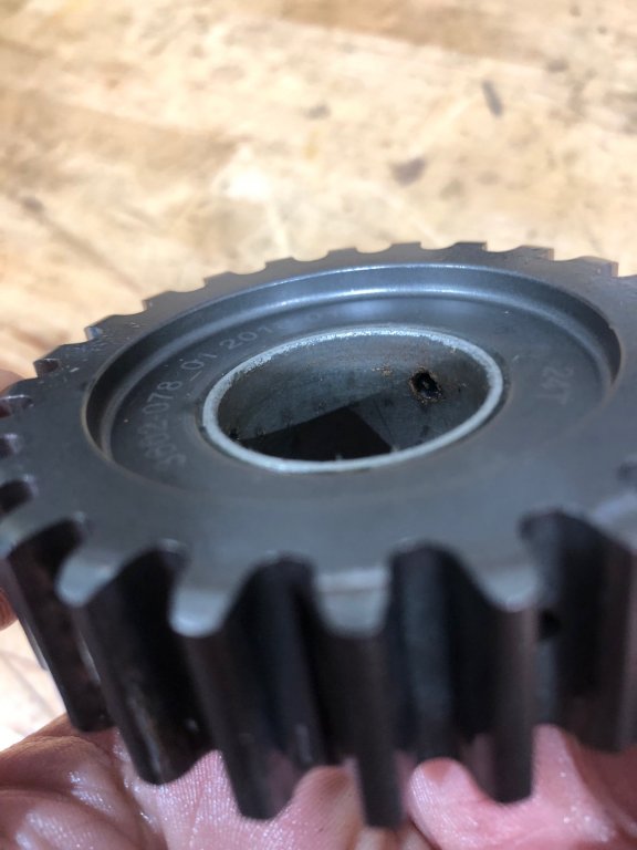

View attachment 147656 View attachment 147655 I have some real world results now. Couldn’t take it anymore so I tore into the chaincase last night.
I was ruining bushings every 1000 miles on my turbo viper. Tried the 660 bronze bearing and it lasted for 1500 miles last year with one oil hole. I purchased the 15 wide upper gear and chain this year as I wanted to upgrade from the stock 13 wide viper chain. The 13 wide and 15 wide use the same exact bushing so that makes no difference in the life of the bushing as the surface area is equal.
So with the stock bushing and three oil hole upper gear I have over 2000 miles on it this season. About half the time I was above 300hp at 18psi boost pressure so it was a good test. I also have good traction with 1.375” track and around 240 studs.
Are you no longer recommending the SAE660 cast bronze bushing? The specs for it make it appear to be a much better bushing for this application than what the OEM bushing is.

See the crud along the top edge of the bushing in the pic below? I am pretty sure that is the teflon material that has been "pushed" off the sintered bronze layer underneath due to shock load.
