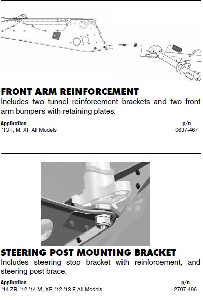

Few more have broken this shaft this year. Shame. Buddy just looked at his 800 cat with QS3. Shaft is bent with 2000mi on it. I found this today also. Could be used to fix a tunnel which bolts ripped out or cracked if you don't want to fab one yourself.
Cat Parts
These front arm reinforcement bracket might be a good idea for my xtx/146" conversion, if I need to drill that lower hole for the skid arms, if not should be good cheap insurance.
