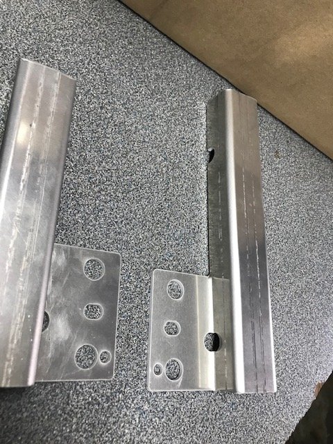

I think I pretty much have this wrapped up. Need to adjust the holes a little bit on the plate layout. More details later today hopefully after I install it on my sled from start to finish. If it works like I intend it to, install will not require gas tank or driveshaft removal, and the bracket will also have an additional m6 mounting bolt.

Travis, so you are making two now?(one for each side)
I was thinking you would have the bolt tab extend the entire length, and have the 2nd bolt you mentioned up near front, under header shroud.
As you know there is a header shroud bolt that comes down thru tunnel up there already, Maybe that would make sense to use that same spot?

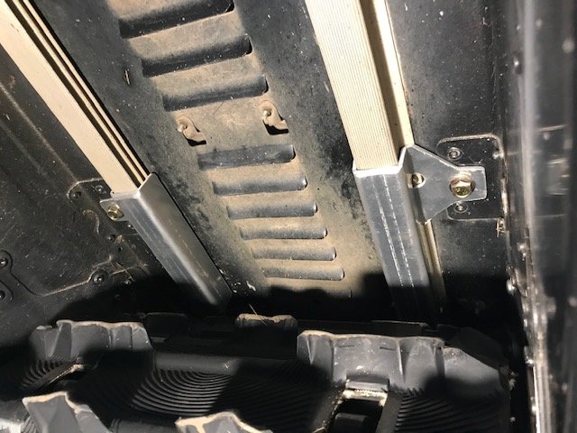

Ahhhh...got to love the cat build quality. So I attempted to mount a set of guards on my personal sidewinder from start to finish, only to find out the rivets on each side of the mounting hole are in different locations compared to the tunnel I used to make up the prototypes.

Trimmed up the protectors and got them installed. It appears it's anyone's guess as to where the rivets will be, but the modified mounting tab will hopefully provide adequate clearance. Revised drawing to reflect the changes and ordered some more new plate blanks. I was also able to shorten the protector by 1/2" to get the leading edge father away from the contact zone where lugs appear to make contact on protector.
