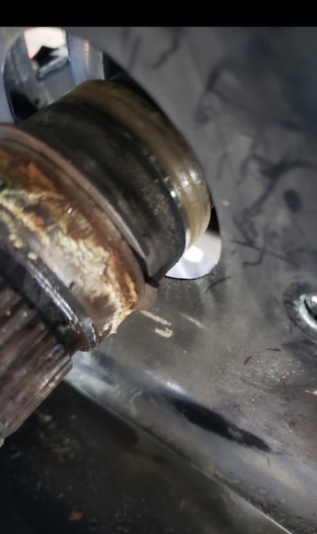

I have a little over 45oo miles on mine from last year. It did not work well. serviced my sled last month and the bearing was flopping around. Shaft was worn down to 1.65 inches. I did not have the wedge in all the way, had it to where you could get a wrench on the flat spots. Had it torqued to 35ft/lbs. Got a brand new shaft, put the wedge all the way in to the washer and set torque to 45ft/lbs for this year. As bad as mine was worn, I had no symptoms on the sled. Place I sent it to be fixed said I had the worst one he has seen.

So I wanted to update my BOP Wedge usage. As you can see from the pics the shaft was warn pretty good, but with the additional torque there was no evidence of the shaft spinning in the bearing race after last seasons use.2017 LTX LE call it 3800 miles, i had it apart last season and it was fine, no wear at all. Took it apart last weekend and It now showed it had spun, but not bad enough to replace. Cleaned it up inside and out and at 55 lbs made it firm so i gave it an extra bump to 60 ft lbs. Used never seize on the contact surfaces and blue locktite on the bolt. View attachment 151475
I had the shaft replaced under warranty before it expires and the Nachi bearing looked new so it was put back on the new shaft. I will remove the bearing to repack and test how much torque is needed to once again lock the bearing to the shaft with the BOP Wedge. Moral of the story, don't be afraid to torque these things up if they need it.
