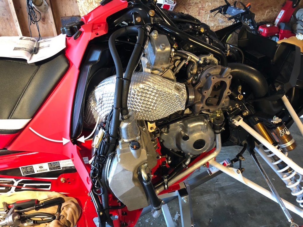

Here is a pic with tank on, but seat off and knee panel removed....hoping we can get a wrench back on there. Maybe will be able to get a box end wrench onto the nut which is ontop of tunnel, to hold it...then unscrew button head under tunnel from bottom, and install protector, and then screw back in, while box wrench holds nut on top all in one motion.
Worse comes to worse, the tank can be slid rearward a tad to reveal the nuts to get at them easily...but frame members would need to come off to move tank even a little.....but i think all the pump and wiring can stay put, which is the pain in #*$&@ when removing tank altogether.
Dan
I just put my panel back on
I’m hoping to sneak it out. Well better to do this now than hose punctuated on side of the trail

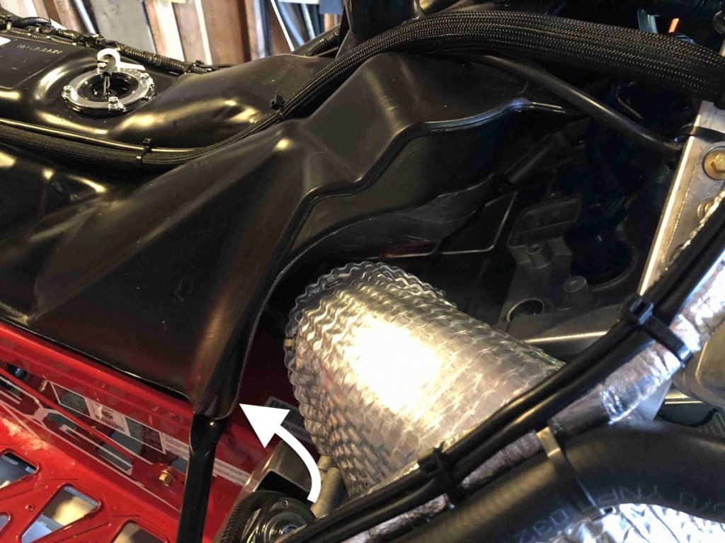

I was just looking thru my pics...this one looks like it might be accessible without removing anything but side panel....not sure about clutch side tho.

Dan just went and looked all kinds of room. Pics are both sides exhaust and clutch side.I was just looking thru my pics...this one looks like it might be accessible without removing anything but side panel....not sure about clutch side tho.

All my prototype installs were done with tank in place. I just took the screws out where the tank cover attaches at the footwell, so I could pull the plastic back and get right to the nut with the open end of wrench. Easy installation was a high priority when I was coming up with a design.
