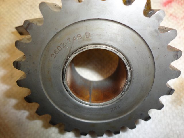

And dont forget that top gear. Warranty it. They wear and need something better in there. Here is mine once again at 5500 mi. Second one. Chain 1.5 turns out bushing is .003 in wore on a taper. If out of warranty buy one they are cheap. Around $20 dont chance it. Even if not under warranty please turn it in so Yamaha knows this is a issue and does something about it. When this gear doesnt mesh correctly with other gear the problems start.

Thanks guys no air freight landed today but should be here Monday gonna tear it down Sunday in case any gears need changing hopefully not with only 1000 km only couple more runs for the year and let dealer check it all again in the fall
