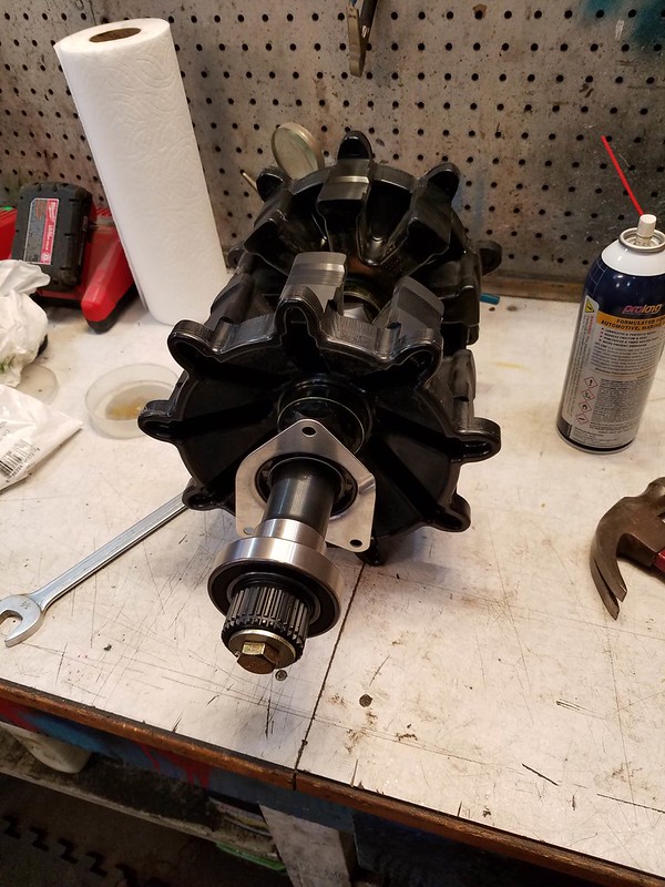

New Drive Shafts are built a little heavier.
Barn of Parts Drive Shaft Saver did not fit without using a brake hone on the I.D. of shaft.
I added a washer & longer grade 8 bolt for total thread engagement.
Bearing got tight before 20ftlbs. Nice! Installed shaft and locked down to 30ftlbs. I don't see how it could spin again.
Old shaft had 7400 miles.
Original bearing was smooth, viscous, and seals tight. However 7400 miles is time to replace anyway for peace of mind.
One more shaft to go and we're ready for the season.
Original bearing was smooth, viscous, and seals tight. However 7400 miles is time to replace anyway for piece of mind.
Do yourself a favor and torque it to 45 ft/lbs minimum.

It’s a piece of garbage, there’s a reason the German made equivalent is three times the price. I had my driveshaft out at 3k miles and there was literally NO GREASE in the bearing.

Is it safe to say that even if the bearing required light pressing or “motivation”to install on the shaft that there is no way the driveshaft saver would be strong enough to expand the shaft enough to damage the bearing or cause premature failure?? I would think think it would be near impossible.Do yourself a favor and torque it to 45 ft/lbs minimum.
- 21,639
- 9,263
I would agree it wont damage the bearing.

I had the shaft from my winder chrome plated and had it turned down to 1.7715. For install the shaft went in the freezer for 24 hours and inner race of the new SKF bearing was heated to 200 + * and still had trouble getting it together fast enough but got it done. I know it wont spin but still installed the drive shaft saver and torqued it to 45 lbs. Taking no, none, notta, zero chances any more with these shafts.Is it safe to say that even if the bearing required light pressing or “motivation”to install on the shaft that there is no way the driveshaft saver would be strong enough to expand the shaft enough to damage the bearing or cause premature failure?? I would think think it would be near impossible.

I did pretty much the same and still used the driveshaft saver as well. I just figured that everyone seems to be concerned with finding the right torque spec for their individual situation. If theres no risk of damage then everyone should just crank it down to the high end of the torque range and eliminate the guess work and wondering if its working or not. Of course this method may not work if your shaft already has wear but on new installed shafts or new sleds I say crank it down.I had the shaft from my winder chrome plated and had it turned down to 1.7715. For install the shaft went in the freezer for 24 hours and inner race of the new SKF bearing was heated to 200 + * and still had trouble getting it together fast enough but got it done. I know it wont spin but still installed the drive shaft saver and torqued it to 45 lbs. Taking no, none, notta, zero chances any more with these shafts.
I dont think we have a choice. Some of us including me were concerned that totally locking the bearing to driveshaft would cause a different type of failure due to chassis flex. Possibly the shaft or bearing failing instead of inner race slipping. The goal was to just make it tight enough to not spin but to be able to move in a extreme event. Probably impossible to achieve. Some have seen even green Loctite fail to hold the bearing from spinning but nobody I know of with one locked tight has had any failures elsewhere. I too am locking mine tight this year. Done messing with this.I did pretty much the same and still used the driveshaft saver as well. I just figured that everyone seems to be concerned with finding the right torque spec for their individual situation. If theres no risk of damage then everyone should just crank it down to the high end of the torque range and eliminate the guess work and wondering if its working or not. Of course this method may not work if your shaft already has wear but on new installed shafts or new sleds I say crank it down.
